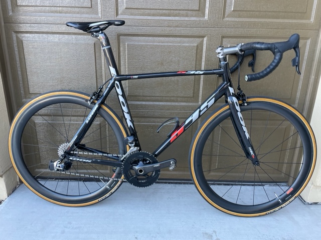

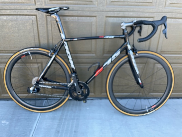

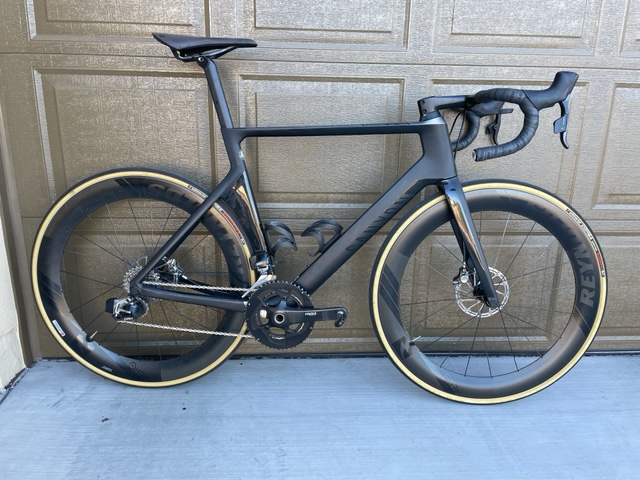

I’m aiming at doing a few ‘epic’ climbs in my region and wondering if I should re-build my old Look 595 as a ‘climber’ or simply ride the Canyon Aeroroad Disc. The climbs are +/- 30 miles and +/- 8,000’.
FWIW, I’m only a couple of pounds from optimal weight (for me) and can drop those pretty easily.
The difference between a light aero bike (Aeroad, Venge, Ostro, etc) and climber bike with the same components will just be a few hundred grams. Doesn’t seem worth it. Is the Look frame even lighter than the Aeroad? If not, just put your light components on that.

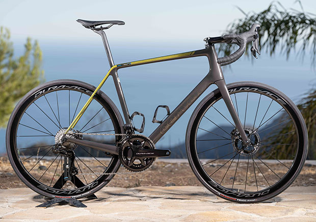

climbing bike:

climbing bike is ridiculously light, maybe 15lb. aero road bike is still pretty light, maybe 17lb. not much difference really.
but the climbing bike also has gearing and tire spec that has climbing in mind, for the climbing i do. i ride up a lot of high mountain passes where there are freeze cracks in the pavement and it’s like washboard on the way down. so, the climbing bike has 32mm tires.

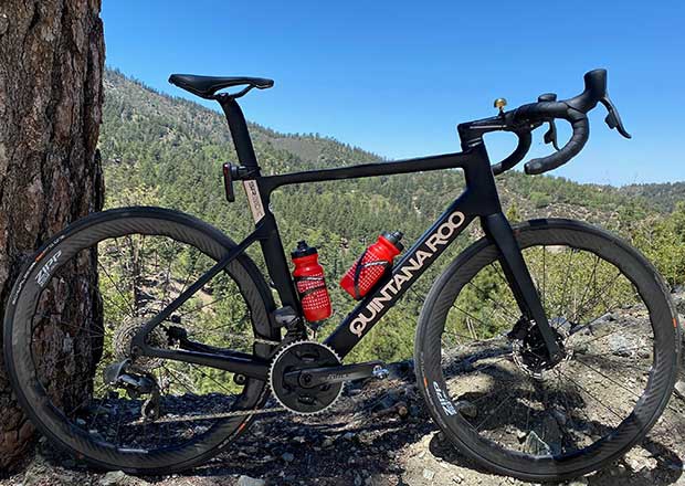

Climbing bike 5.4kg (11.96 lbs) as pictured.
https://i.imgur.com/7qqPM2u.jpg
Since upgraded the saddle seatpost, cassette, and wheels/tires to 4.9 kg/10.8 lbs.
