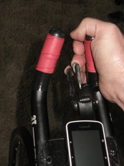

If you flipped that remote so the buttons are facing forward/down between the extensions, then they’d be right where my modded flatbar shifter are now. You can use your fingertips to shift. The clamp is the same diameter… extensions and MTB bars are the same size.
Do you have a picture of your current set up?
Again I am not saying it can’t be done as I could make something work very easily but it is not ideal and if they could have it placed like standard road and tri shifters, they would have a lot more sales.
