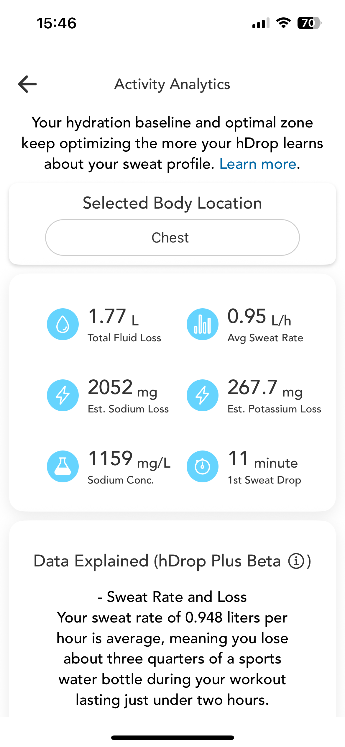

Fluid Loss: Gives you a ballpark figure (I often weigh myself before/after and compare) of fluid loss for your workouts and recommends replacements.
Sodium Loss: It quite accurately matches my (tested with Precision Hydration, + multiple additional tests) sodium concentration/loss for a workout. Which is helpful to know.

Example from a recent workout as an example.

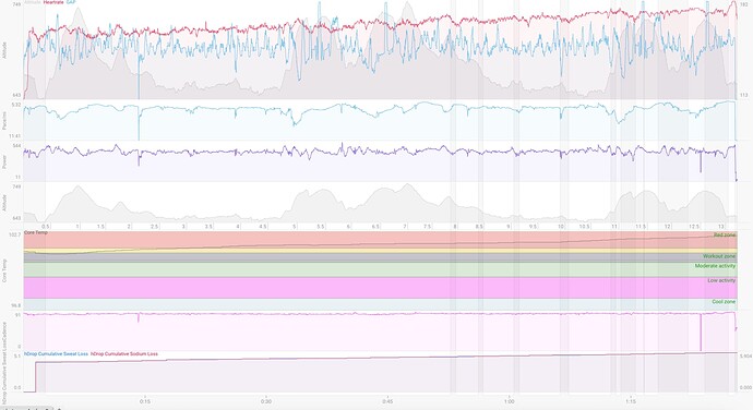

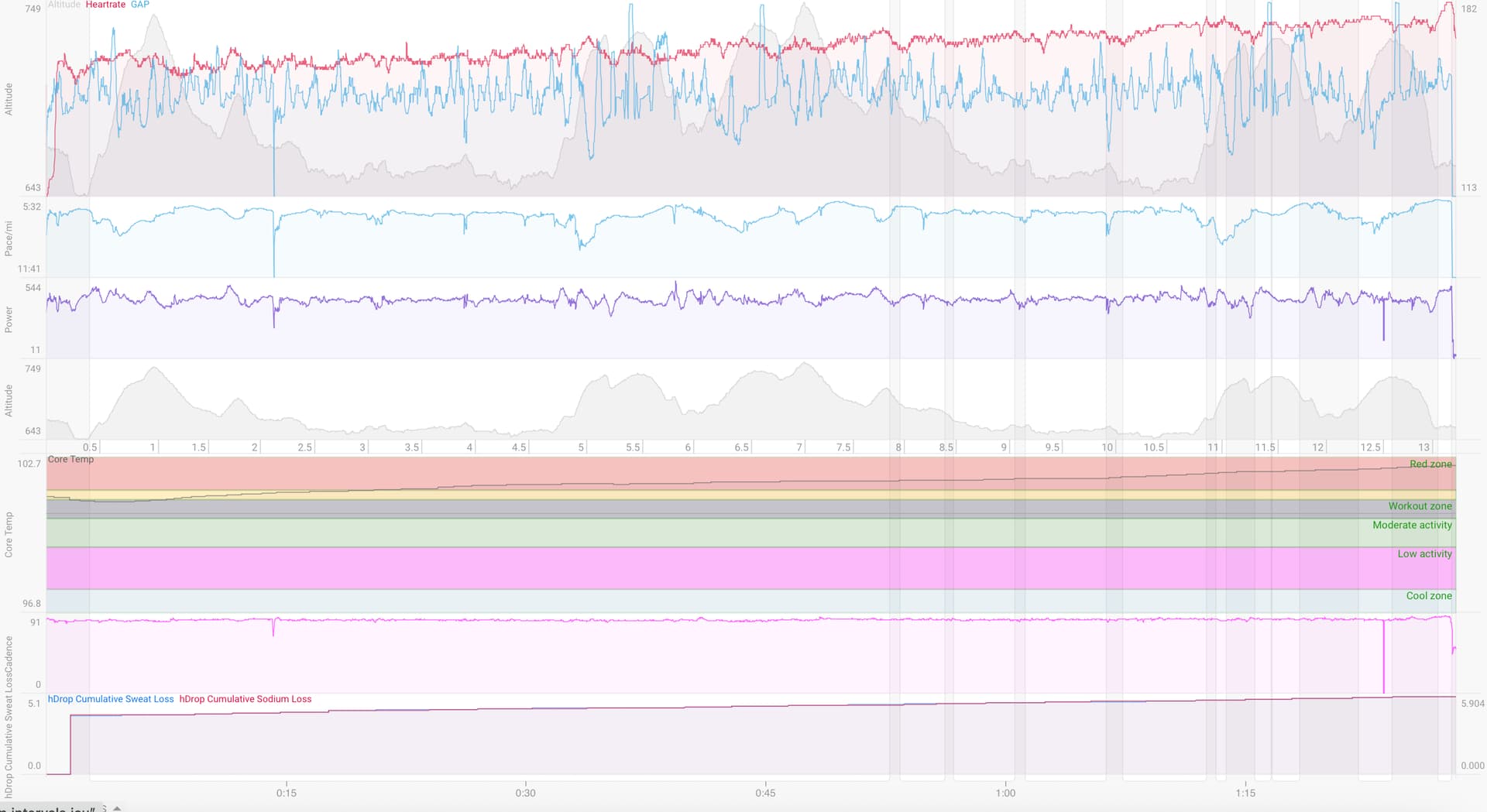

Re: Dousing with water … good question, I somehow dont think so, but dont have good examples or tests to validate. Here are some screenshots (from Intervals of the data points during an effort). The Hdrop data is down at the very bottom.

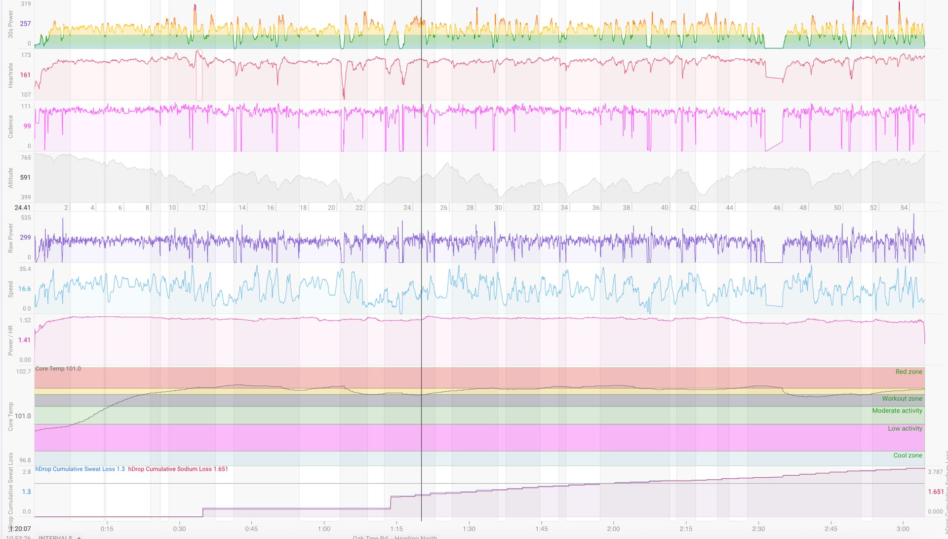

Here is an example of where I would have doused myself with water (70.3 run) but the results dont seem to be skewed.
