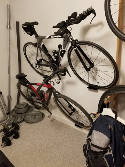

Are these safe for the bike? I know pedals and the crank take a pounding riding but just want to make sure it’s okay.
Have 3 daHangers. Used them for the last four years or so. All good. Don’t think it’s nearly the same load as me pedaling for hours at a time.
Are they secure…meaning won’t slip off?
Yes
Works great. Holds solid and saves space. 2 thumbs up.
I got some off brand ones from Amazon. So far so good. Bike is super secure. Make sure you mount the pedal part into a stud and you’re golden.
The wheel brackets are fine in drywall with appropriate anchors. They don’t really have much load.
I can’t imagine the force of the bike leaning out is more than what I’m applying when pedaling.

In our garage, the Mrs and I have 9 bikes using D’Hanger. This is our 2nd house using them. Total satisfaction!!! 4 thumbs up!!!

I have some knock-offs and they are good for me, not so much for the wife. She has trouble getting any bike on/off above the lowest rack. Take your time with installation and mock it up for your space as they can they are size specific to a degree in terms of wheel holder placement. In my case the lightest bike is on the bottom for the boss;) Speedplays are the most challenge due to size.

I installed some cheap Amazon ones but one broke so I’m returning. However it did give me a good idea of how it would work out. I ordered the DaHanger ones. Very expensive for what it is.

Yeah, super secure. No way to slip off.
I have them in my home and like them very much. They work great and I have no fear of any bike falling off.
