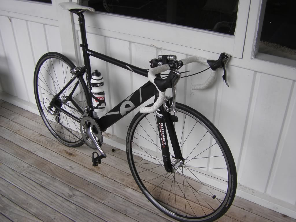

Just finished turning my Blue into a road bike. Only been able to ride it once like this, but so far so good.
http://i45.tinypic.com/wlouhc.jpg
