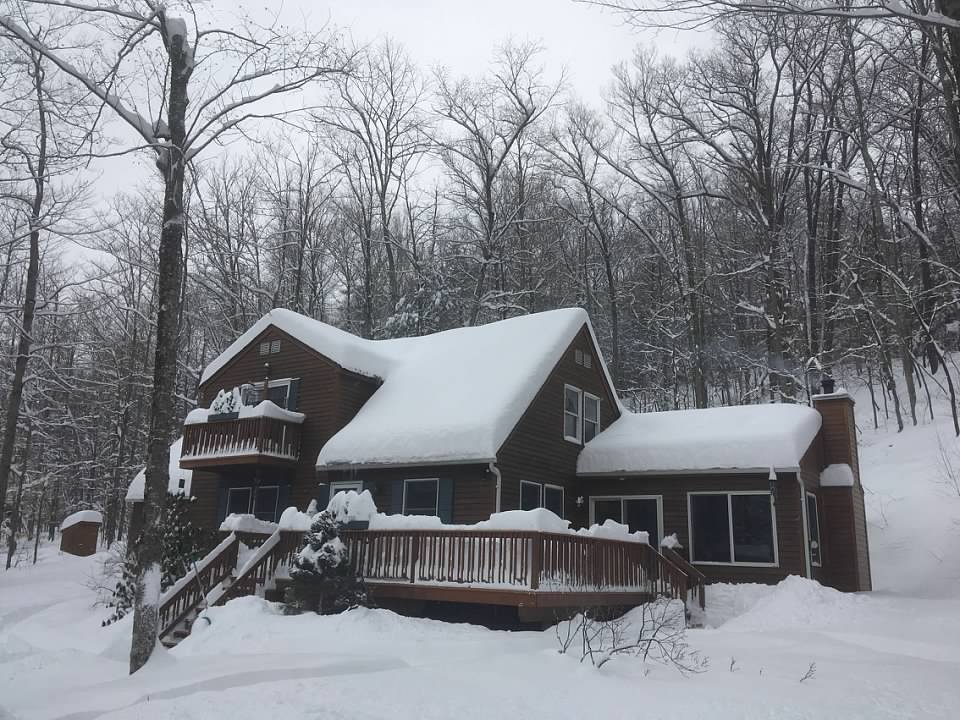

My house;
https://uniim1.shutterfly.com/render/00-LERhMaUle4Z4l4lymfdxsSIVFdi2tcO1HP8enPZvqX7mMtCUT0ep4fBZCegfxOziV7ntXQOewWgszVPDOQPWWw?cn=THISLIFE&res=medium&ts=1612277320
is based on an Alta design, but I built it with 2 x 6 framing, cedar siding, and sheet-rock walls. We loved the log houses when we were planning this but conventional house are much easier to heat, especially for a weekend house.
If you want a country house, buy the land when you can. You can always have the house built. But conventional modern framing will build a better house.
