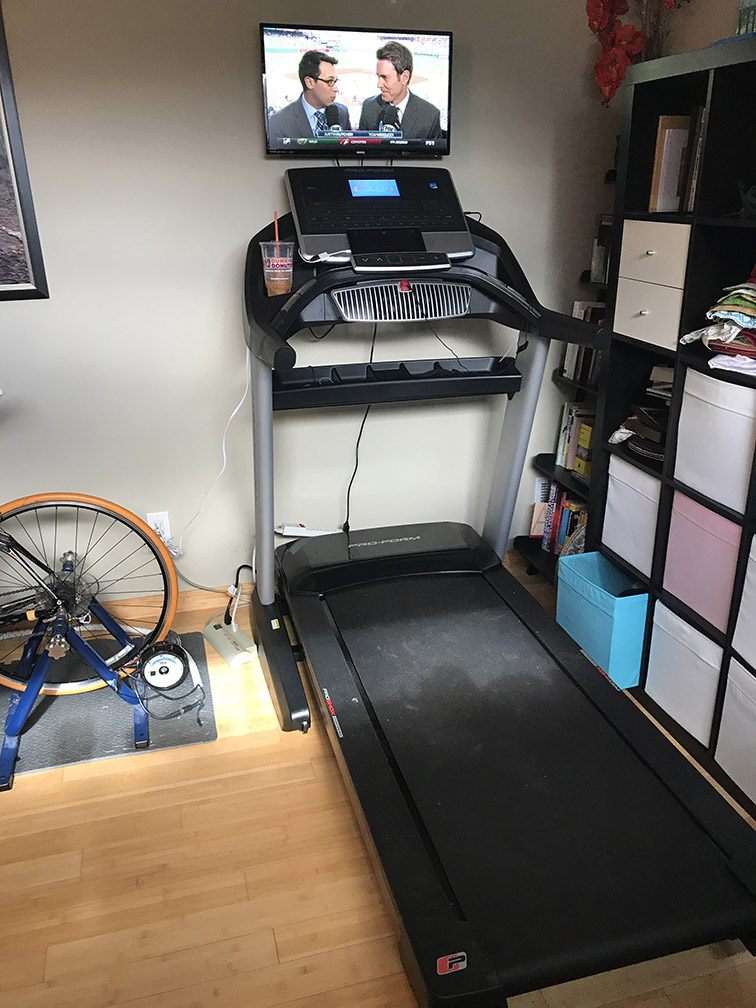

I just setup our new treadmill last weekend. I have an iPad that is used for entertainment, and that is connected to a 27in monitor that I mounted to the wall in front of the treadmill. They are connected with an HDMI cable (there’s a lightning to HDMI adapter that Apple sells.) The monitor I have has speakers in it and the HDMI cable sends the sound to the monitor and there’s no way in an iPad to select something else. So I have a short male-male headphone cable connecting the monitor to the treadmill. Added bonus is there are nice big volume buttons on the treadmill so you can change the volume while running easily.
All sounds great and easy to use.
Do you find that the Dunkin Doughnuts iced coffee is a good pre / mid / post run fuel? I find it just makes me have to piss and gives me the shakes but…

I was actually setting everything up still when I took the pick. Not that I would be opposed to some Dunks iced coffee at the aid stations.
