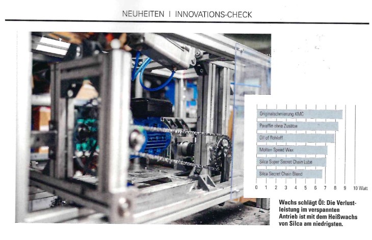

While Gulf Wax works better than most lubes, it’s also independently tested to be less efficient than SILCA hot melt by roughly the equivalent of a CeramicSpeed OSPW upgrade and roughly more than 2x the efficiency gain of a ceramic bearing wheelset upgrade, so if you’re after ultimate speed/efficiency, the extra few $$ for a top rated wax represent a pretty good value.
For the OP, SILCA Chain Stripper is an environmentally friendly(er) way of stripping that chain that takes about 10-15 minutes on a SRAM chain compared to 24-48 hours for most other methods. You can find it and our waxes delivered within the EU from Rotterdam here: https://silcavelo.eu/
Ceramicspeed and Effetto Mariposa also have environmentally friendly cleaners that work pretty well if you don’t want to buy from us.

I use Silca hot wax as it’s independently tested to be the least wear (check zero friction cycling) and thus probably least friction. Lidl had 15€ crock pots online, not sure if they ship to Belgium from their online shop.
https://zerofrictioncycling.com.au/lubetesting/
Ceramic Speed claims Force chains are slightly faster than Red, which is why they sell them and not Red btw. I tend to believe that.
