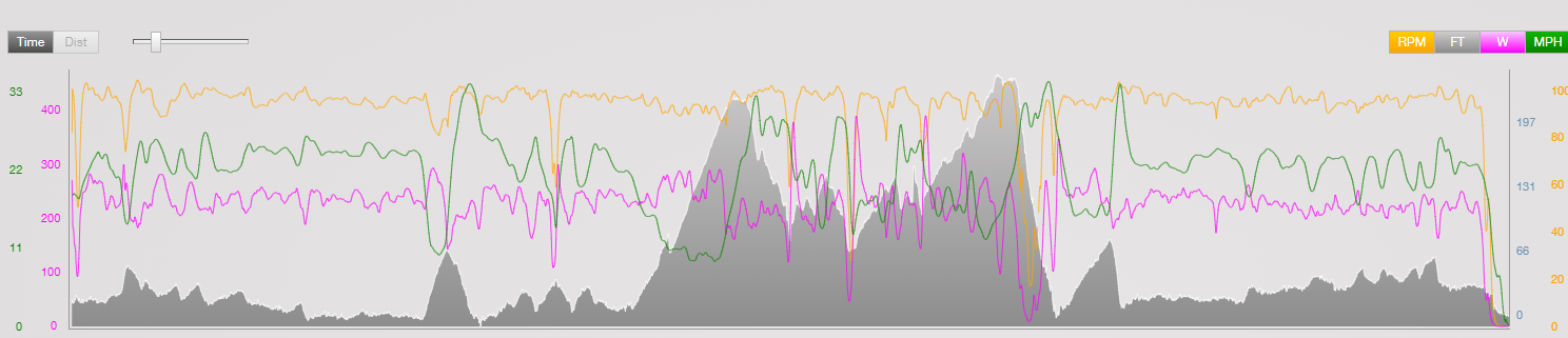

I am a newbie when it comes to training with power, and have yet to fully utilize the data. However, I completed a solid block of training throughout the winter that saw a heavy increase in bike volume. Within this period I set a new FTP of 273, done in aero on the trainer. Power is based off crank arm power meter.
After having done my first 2 races of the 2019 season, I am slightly disappointed with the seemingly lack of gains on the bike. After completing the Monte Rio Olympic Triathlon this past weekend, my power output was the same as that of my first race of the year at the Folsom International Triathlon (also lower than expected).
Monte Rio is a relatively flat course with a few rollers in the middle of the bike leg. There was moderate to high wind throughout the bike as it was along the coast.
My main question is what could be causing the drastic decrease in power when racing outside? I weigh 65.77 kg which would put the FTP of 273 at 4.15/wkg. Looking at Monte Rio, I had an avg. of 226 and 233 NP.
Even if I take into account Normalized Power, 3.54 w/kg is still a difference of 0.61 w/kg! During the race I felt calm and focused, and was seemingly red-lining it the whole time. From what I’ve read it is typical for outside power to be greater than indoor power, not the other way around. Although you typically wouldn’t want to be pushing your FTP for an Olympic bike, shouldn’t there be much less of a difference between it and what I rode?
The one conclusion I have come up with is that indoors, I usually hold a cadence of 80-90 rpm. This ride had an average of 96. Could I just not have done enough miles outside to get used to pushing the same cadence/power as I do inside? I have not changed my position since doing the FTP test about 2 months ago.
Open to any thoughts, suggestions, etc. Thanks!
This is a really dumb question, but you aren’t on a kickr or similar indoors, and then your crank power outdoors?
Reason for asking is that my kickr is 10+ watts higher than my vector 3s, and that has been consistent across 4+ hours of test riding this weekend.
No, I just use my Gen. 3 Stages power meter indoors and outdoors. The readings for it are pretty consistent as well and I always make sure to calibrate it.
One thing I find is that my power drops when going down mild grades (ex. -1%) even though I feel like I’m working hard…something I’m working on fixing. Indoors this is a non-issue. Dunno, but you might be doing same thing.
I sometimes find if you haven’t done enough outdoor riding for awhile is that you can find it hard to mantain the real threshold power you can do, because you’ve got to focus on other things- handling, obstacles, other riders, not crashing, head position etc. On a trainer all you need to be worried about is to keep that power high.
for example, My FTP as recorded on the trainer is ~270 watts, but if I try to replicate that out on the road- it’s really hard and I’m hitting about ~250 watts because I actually have to ride- being aware of traffic,bikes, ease up on corners, dodge holes, etc. It’s not a big concern of mine though, because IMO it’s quite close, less than 10%, and I’m not losing too much sleep over it.
your 50 watt loss does seem a tad excessive for that though.

A 50 watt difference between race day and FTP testing is too big to just be expected variance since it sounds like you pushed pretty hard on the bike.
Are you sure that your indoor power is reading off your crank arm, and not from your Kickr or power controlled trainer? That would be the most likely situation, with differing power readings between both.
I’d normally say swim fatigue, but even if you’re totally out of swim shape, it shouldn’t wipe you out as much as 50w (see youtube Vegancyclist who does a triathlon as a pure cyclist with zero swim training and near-zero run training, and still bikes fine for an Oly for his cycling ability.)

Based on your data you basically raced at about 83% of FTP which is a little on the low side for an Olympic. Realistically you should be up around 90-95% for an Olympic.
Were you monitoring power and targeting a specific power during the race or just riding by feel/RPE/HR and looking at the data afterwards?
One major change that I made over this last season was racing to power, with the top data field in my Garmin being %FTP and having a set % that I want to aim for during that race, with acceptable surges when needed. For my last HIM I targeted 85% FTP and ended up with an average power of 84.8% FTP for a 2:21 bike split.
Lots of variables can come into play on race day which can affect your overall AP and NP. If it is a congested field and you are coasting a lot you will obviously drop more. I doubt it is a calibration issue, as you mention I tend to find I ride to a higher power than expected outside than what I do inside.
Why would you expect to ride an Oly distance bike leg at 100% of FTP? You need to swim first and then run after. You held 85% of FTP. That seems like it’s in the ballpark, maybe it’s a little low, I’ll let the power experts give feedback here, but you should see a substantial decrease from an all out FTP test to what’ you do in a triathlon.
The other thing is how your FTP is measured. Depending on the estimation method used, your FTP estimate could be a bit high.
In short, don’t worry about it. Did you race well? Use power numbers to help you, not to dictate your race.
If your cadence is markedly different between the two situations then you’re doing things differently in outdoor racing than you are on the trainer so it’s unsurprising your results are quite different. However, even were this not the case, I don’t think your results are that out of line. Two things:
I don’t agree about people always performing outside. If you’ve insufficient cooling and stimulation I think it’s the case, but some of my strongest performances up to about 70 or 80mins in duration have been on the trainer with fans blowing and Zwift in front of me. If you’re in the right frame of mind it’s easier to maintain focus embrace the pain. Beyond that duration, comfort and tedium tend to swing performance back in favour of outdoor riding for me.
In a race situation, especially a multisport race, I’m a lot more aware of the need to pace myself. I’ll push harder on the trainer in the knowledge that if I overdo it I can just back of a bit, or in the worst case sprawl gasping or dizzy over my handlebars (okay, you’re not doing high intensity intervals in a race situation so this isn’t entirely applicable). In a race over-pacing can result in a terrible run or in an extreme case, falling off the bike (again, the latter isn’t likely in a race, more applicable to an all out sprint on a training ride).
One other thing, and potentially the most relevant… how did you determine your FTP?
I always use power numbers to ‘dictate my race’.
IMO, 0.85 IF is my target for the 70.3 bike distance. 0.90-0.92 for the oly and .99-1.00 for the sprint. So I actually do try to hit my FTP in a sprint, but it’s damn hard. I hit 0.99 in my last two sprints…

How did you determine FTP? If it was by one of the methods other than a flat our 1 hour time trial (20 mins x .095 for example) that might be your answer right there. I have worked with some athletes who can just push very hard for 20 mins - well beyond 0.95 factor of 60 mins. I personally know I need to be about 0.92 for a 20 minute test - that is just a lot of years of experimenting and experience that tells me that.
If you want your FTP on the road on rolling terrain - find a local 25 mile time trail and do one on the road. Turbo and Road numbers rarely match each other, are different % for most athletes and can cause confusion in TP with TSS scores and the like.

Regarding indoor and outdoor i find them similar enough once route doesn’t include many sections where your easing off power due to lights, corners etc but wouldn’t be the case in your race.
Well, you’re talking about a planned power a lot lower than ftp for a multisport race. Not ftp power vs. ftp power for a time trial only.
Also, in a real race your pacing might take you higher and lower (your VI) than on a fluid or smart trainer at a constant output indoors.
Perhaps attempt a similar “course profile” indoors and see what you get.
It’s one thing to peg it indoors in a super steady controlled situation with no other focus than suffering the output versus outdoors where you’re encountering gradients and having to focus also on steering the bike.
I’d say the old Coggan “best indicator of performance is performance itself” would lead to doing some outdoor simulations to see what power you should target.
