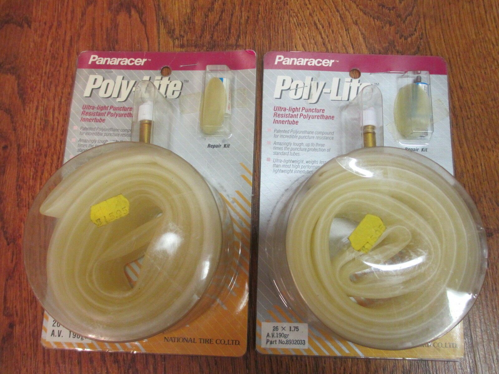

Companies have dabbled with TPU tubes since the '90s (below). I think the main barrier to adoption is that the price point is simply too high. They may be a good all-around solution but are 4x the cost of butyl and 2x latex, and aren’t faster than latex or more air-retentive than butyl. At $12-$15 a tube they would probably be a no brainer high performance training tube for many folks.
https://cimg0.ibsrv.net/gimg/bikeforums.net-vbulletin/1600x1200/panaracer_poly_lite_tubes_ed5dd2e313a1cf56351d75e10f1a292cbc362d47.jpg
