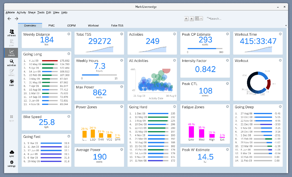

Thanks for kicking off Marc,
To let folks know, it will be a total rewrite, so nothing is off the table- small or large.
We are working towards a totally new GC v3.6 for next Summer with everything modernised and a UX that makes GC best in class…
Cheers
Mark
