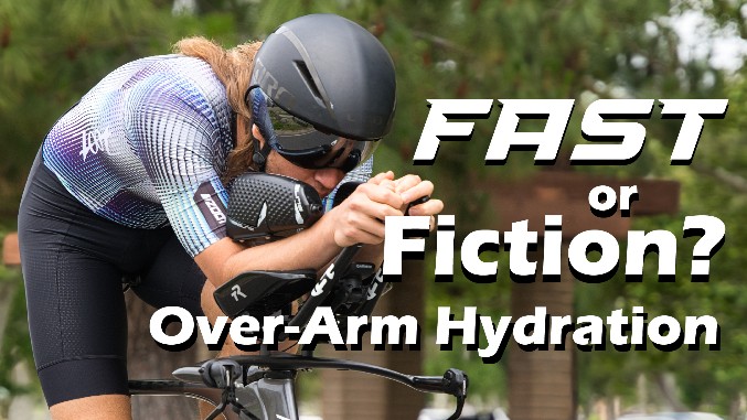

A client of mine made his own Overarm Hydration setup similar, if not identical, to the Revolver version used by Joe Skipper recently at IM Texas. We decided a quick aero test was in order and created a short Fast or Fiction video: https://youtu.be/nMaxivCo4K4
Just under a 3% (2.95%) drag reduction for this client at race pace. For him, that equaled a 6.2 watt savings.
A few notes:
The wind conditions made for a very low yaw environment at 2-2.5 degrees. I suspect we’d see a little more improvement somewhere between 4-7 degrees. Revolver claims “up to” 23 watts of drag savings, but give no other relevant information on what those watts are based on. Looking at their Instagram post, one of their test athletes had the bottles right up against his biceps with a fairly short reach. I’m guessing he’s the one who saw the bigger savings and it was at high yaw. I could be wrong, of course, but that’s my guess.Our athlete reported no issues with vision. Getting out of the position and to his brake levers wasn’t difficult, but a slightly different movement than usual. He noted when he had his head tucked, his helmet would touch the bottles and that would likely get annoying after awhile.Any questions? Chest bottle test video will be released this week. We tested 9 athletes with different size bottles and there were some very interesting results. I’ll post here when it’s released. Aero socks and calf guards are being tested now, again with multiple athletes. Look for that video in 2 weeks or so. Lot’s of other stuff in the que for the next few months. YouTube Shorts for quick tips. Longer videos when warranted.

What setup are you comparing the 3% savings to? Did the original setup have bottles in a different location, or is it just comparing a no-bottle setup to the overarm hydration setup?

Baseline, no bottles anywhere.

I think because they’re useable water bottles, it’s not afoul of the rules just yet. I could see it being outlawed for safety reasons more than anything else even though our athlete had no problem with sight or getting to his brakes quickly. Still, I could see that being used as the excuse.

We did test a 3 liter Camelbak bladder on one athlete and we’ll mention it in the video. There was a decent gain but not as good as the bottles (28 oz and 1.5 liter). If I remember correctly, and I’m old so maybe not, it landed between the two…or it didn’t, I forget. But it was a gain, or drop…however you want to say it. Lol.
