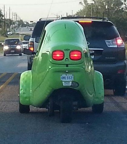

saw this a couple years ago. A few months later my Brother-in-Law got a new job and it turned out this is his boss’ “car”.
http://i1142.photobucket.com/albums/n607/Harbo99/dimple.jpg
Corbin Sparrow?
