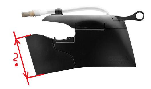

Did some math an it seems that in my case the space from the bottom of the hydration to the brake mounting bolts will be 23mm. Can someone be that kind and check on his/her Aeria this measure from the picture?
Must have missed this originally. That side measures 4 5/8 in
Thank for your reply Ryanppax
This means that there is only 1,3cm of free space between the bottom of the hydration to the brake mounting bolts. So it will be quite difficult to fit that Aeria there with fully functional front brake. Probably I will have to swap my front brake for Tririg Omega or something.
