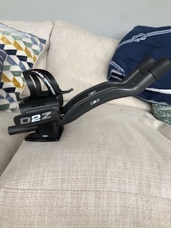

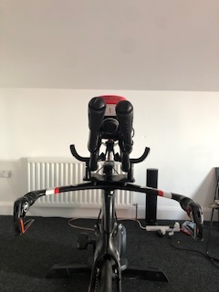

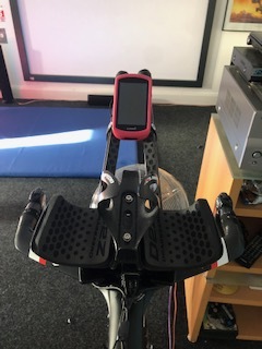

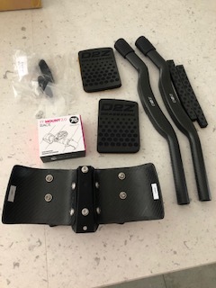

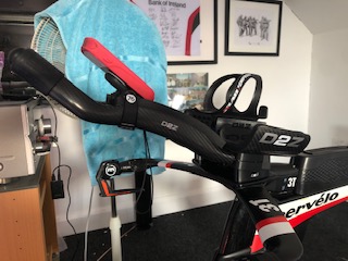

Hi yes I’ve recently done a full drag2Zero cockpit if you want to pm me and I’ll email you some photos (they’re too large for here)
Many thanks I have PM’d you, Cheers
