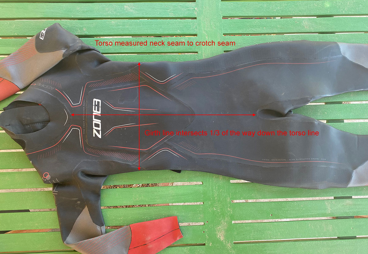

folks, i’d like you to do something for me. i’d like you to measure your best fitting wetsuit, even if it’s a bad fitting wetsuit. the measurements i’m looking for are the height, and width, of the wetsuit’s torso, measured at the neck seam, and the crotch seam. like this:
as to the width, the intersecting line is exactly one third of the distance of the torso length down from the neckline. spread the suit out flat, don’t stretch the rubber, but measure the width. basically, you’re measuring half the circumference at that spot.
if you have any questions about this, how to measure this, or if your wetsuit doesn’t “behave” because it lacks these seams in these places, please post here with details (the wetsuit brands and style, perhaps with a pic).

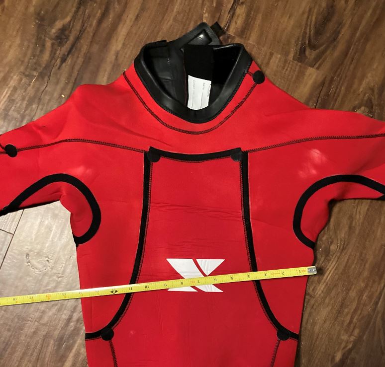

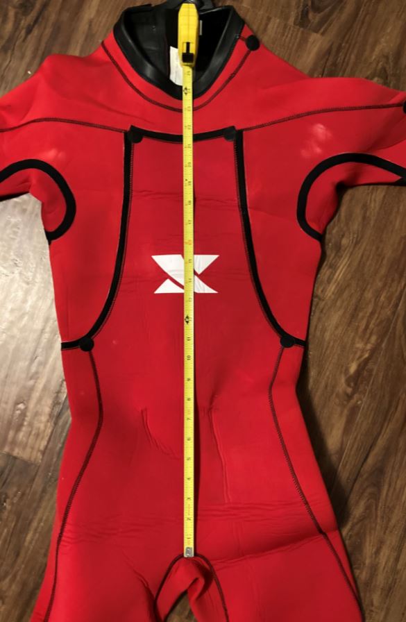

    Another Xterra Vector pro
Xterra vector pro
torso length 23 inches (58.4 cm) collar seam to crotch gusset seam (see picture) The gusset is 3.25" (8.3 cm) wide.
torso width 14 inches (35.6 cm) across the chest right over the logo (see picture)
  1. my height 5’10", 70 inches (177.8 cm)
    my inseam 32.5 inches (82.6 cm)
    ~165 lbs (75kg)
  2. While I’m not 66 years old, I find this suit to be too short in the torso too. It’s hard to get over my shoulder and nearly impossible to zip up on my own. Also has some shoulder restriction once on. It’s a little tight in the chest, but nothing I mind. Like Tobrien, it was hard to get over my heals until I cut over an inch off the legs and arms (skinny foot opening).

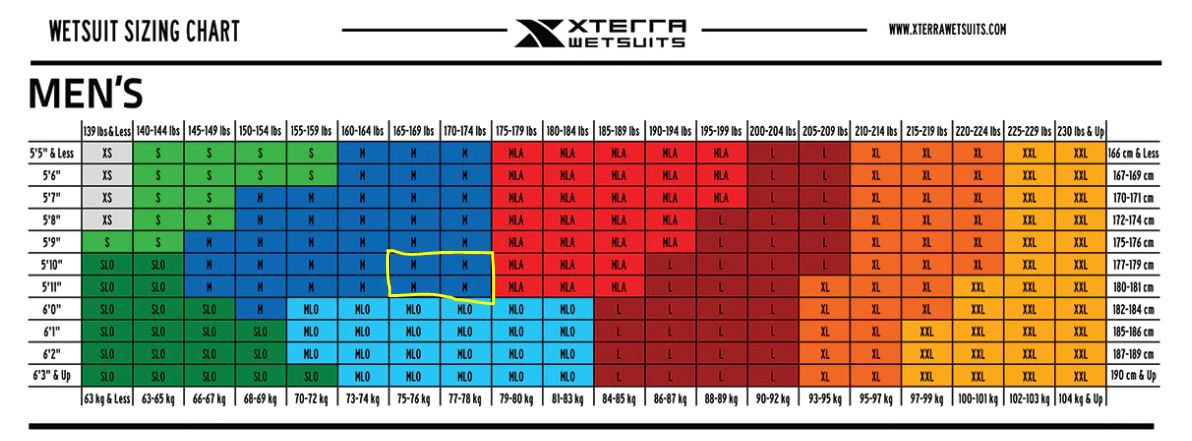

I was just looking at wetsuits again to size up after reading the front page article and wasn’t sure if a medium long would increase the length in the torso, legs or both. I’m roughly in the intersecting corner of medium, medium-long and medium-large
