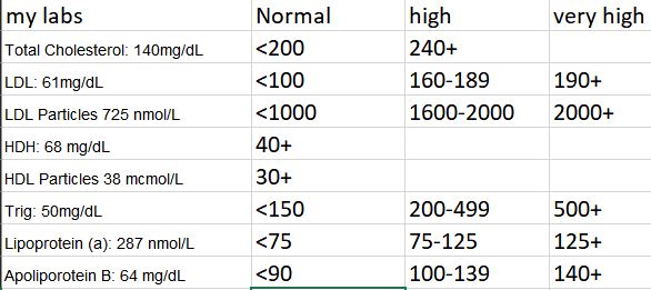

here ya go (these the reference ranges in my lab report. I believe a typical LP(a) is around 30-50, and 75 is where they start to see increased risk, but they research is ongoing.
(adding a capture of the chart since it didn’t paste very well.
My level Normal high very high
Total Cholesterol: 140mg/dL <200 240+
LDL: 61mg/dL <100 160-189 190+
LDL Particles 725 nmol/L <1000 1600-2k 2000+
HDH: 68 mg/dL 40+
HDL Particles 38 mcmol/L 30+
Trig: 50mg/dL <150 200-499 500+
Lipoprotein (a): 287 nmol/L <75 75-125 125+
Apoliporotein B: 64 mg/dL <90 100-139 140+
