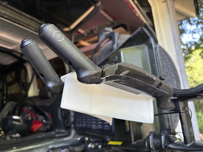

Who made the reach extenders ?
Were they tested with that specific base bar ?
Speedbar printed them and they’re bar-specific and structurally sound, not a pieced together solution
They’re the same risers you saw in person during the aero testing you did last year for Trevor

Looking at the pictures this appears to be a piece of carbon attached to exisiting extensions (Speedbar?). I was told to remove a molded piece of carbon from my bike that was molded around the bars (yes, it was a fairing). But when this piece of carbon is molded and glued on at a factory that is okay? Is the purpose of the rule that fairings are allowed only if added by the manufacturer?
IM and WT really worked themselves into a corner by allowing so much creep in their interpretation. First it’s ok a to have an aero shaped bottle Then it’s not a fairing to put nutrition/hydration into aero shaped carriers. Then by comparison it’s not a fairing if that nutrition carrier fills gaps between arms. Then it can’t be a fairing if you have the same “nutrition carrier” that’s just a plate under the bars. Now it’s not a fairing if what used to be a nutrition carrier has winglets on it to shape airflow and no nutrition carried at all.
They had 100 chances to draw a line but always kept it up to individual official’s interpretations.
But if this ‘fairing’ really works, couldn’t we learn how strategically shaping even separate extensions could be beneficial ?
Yeah 100%. Fully onboard with optimizing aerodynamics within the rules. Not a fan of having to guess if your new equipment will be allowed. My first intuition is that an air deflector that far away from the rider’s legs is going to be very position-dependent, but would love to see real world testing.
TBH the interpretation of the rule pretty much seems to be: Appearance of being made professionally = OK, Appearance of being homemade = Not OK.
If this new piece didn’t have Velovetta stickers, was glued on with white epoxy and little bits of glue overflow that weren’t cleaned up, and was made of ABS plastic instead of carbon would it still be allowed? Functionally it’s the exact same piece, but we all kind of know the answer.

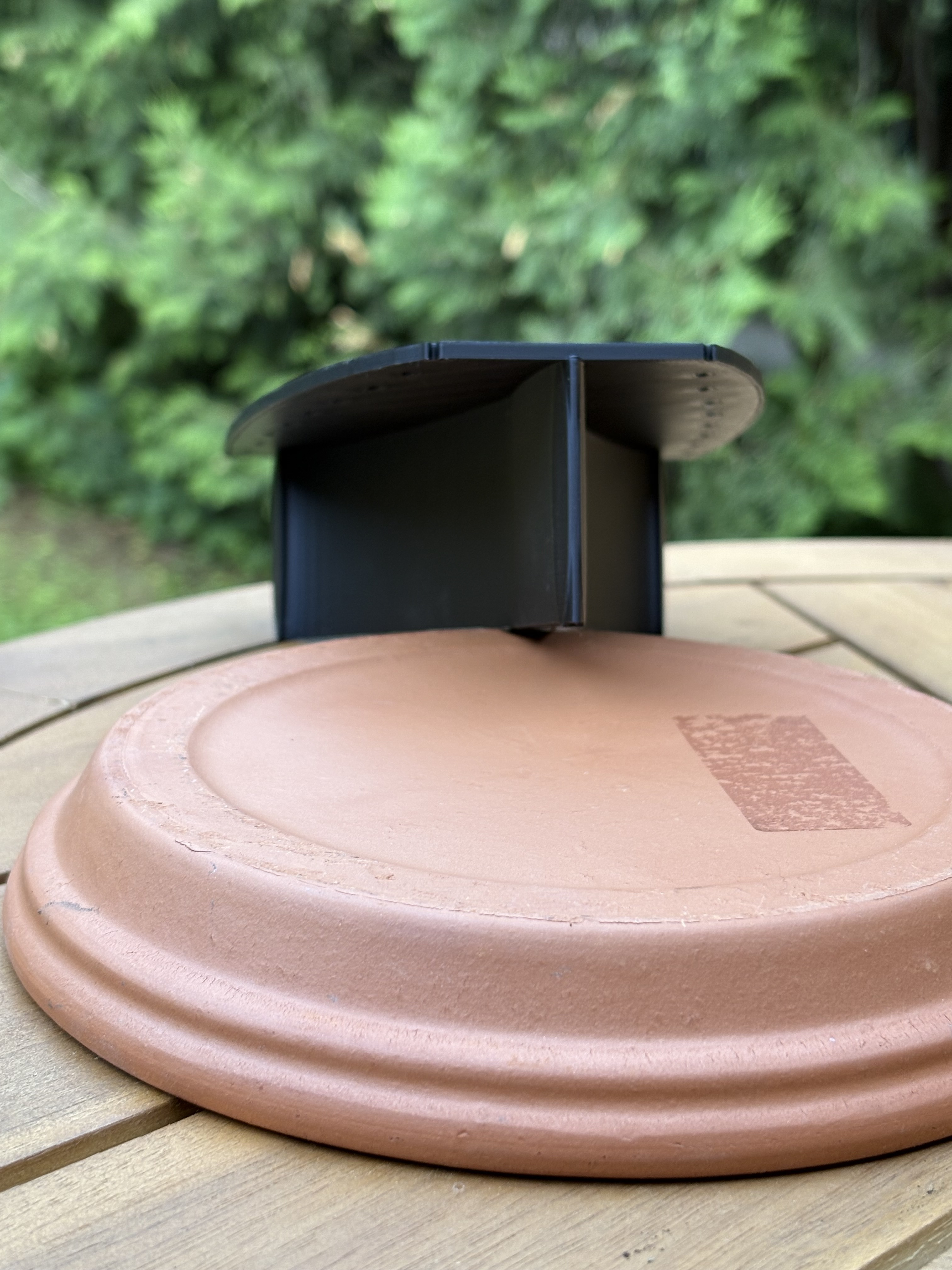

I hope “strakes” don’t become a thing (very clearly a fairing IMO). Ultimately we’ll end up with some overly complex regulation that bans them…along with a bunch of collateral damage to other, existing designs in a replay of the hydration rules.
[color=hotpink]Joe Skipper is already busy bolting two aero bottles under his bar to form a strake.[/color]
I plan to drop them lower and lower until they cover the front wheel.

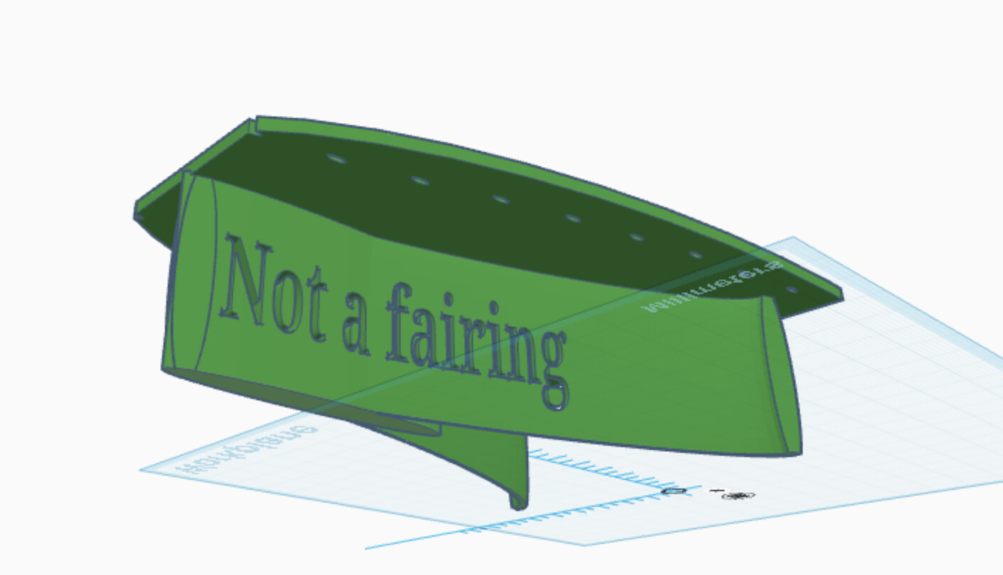

“Honey I need a bigger printer”…
No but seriously, this could be interesting if they do work. Any ideas welcome.
Adding embossed text to trip the airflow? :slight_smile:
(jk, probably wouldn’t help)
