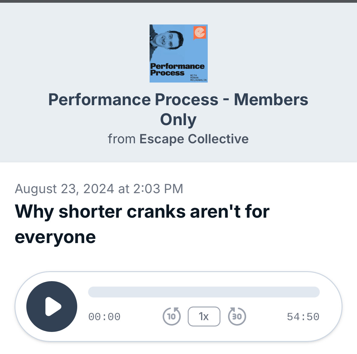

Discussion with Ronan over at Escape Collective that discusses bike fit with regard to saddle positioning, and how that affects the decision for crank length:
link to podcast: Transistor.fm
As for getting comfortable when rotating onto the pubis bones and being more on the nose of the saddle, this requires the saddle being at the right angle, the saddle cover material having the right amount of grip, the rider being in a balanced position over the bottom bracket, and having the front end at the right height and distance so that being on the nose of the saddle is very comfortable. This is also why the channel width is crucially important: rotating more on the nose of the saddle will create more soft tissue pressure, so having the channel wide enough was critical in the design of our saddle. These pro athletes are on the nose of the saddle because that is where they are most efficiently producing power.
