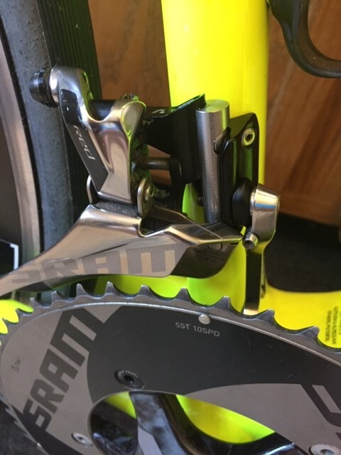

Similar problem. Front derailleur mount was designed around cx chainrings. I made a couple spacers to shift the derailleur up like 10mm - I liked the stainless one better so that’s what I’ve got installed.

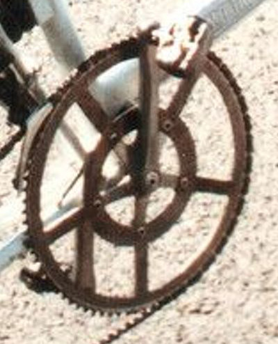

Made as a favour by a workmate, well you need a 80 tooth chainring when your wheels are only 17inch!
