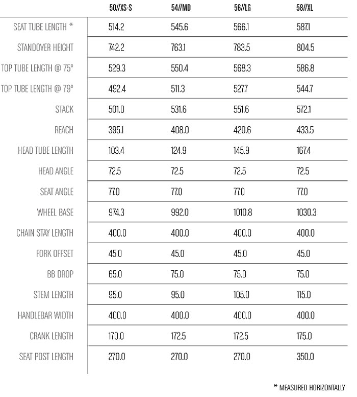

I understand the large frame (56cm) is the correct one for my height, but my question is: given that this second hand frame is cheaper than if I bought it brand new, would I be able to adjust the 54cm frame to make it fit* as well* as the 56cm frame?
Here is the sizing/geometry data for this frame (see attached photo).

Would you be able to asses the fit based on the geometry data given?

I get the impression you don’t have a TT bike, so you don’t have current stack and reach X/Y numbers. Basically a 56 is like a 54 where top tube is an inch taller and the stem and saddle setback are each 1/2 inch “longer”. If you dont ride a totally slammed setup, the height shouldn’t be a deal-breaker as long as there steer tube hasn’t been cut super short or there are no spacers for the bar/pads. If the bike is built up I would hop on and see if there is any room for adjustment with the seat post. You mostly need to worry about setback.

I’m 6’ and the stack on the 54/M is way too high for me. I’d need the 50/S size.
I think the M will be fine unless you like very low bars (like me). You can make the effective reach longer with a longer stem.
I am 5" 11 with an inseam of 31"
You have a short inseam for your height, which improves the chance that the 54 will fit (for ref. I’m 5’8" with a 30.5" inseam and nominally ride a 51cm road frame [my current BMC is a 51 and my 52 'dale fit “ok” but was a bit too tall).

Thats not enough info to get a accurate fit. Do you like you current position on TT bike? Do you have a TT bike now? Have you ever been fit to a TT bike? If your answering these questions as a “no” then you need to get a fit first before looking at new bikes. Once you have fit numbers then you can start your search for a new bike. With out the fit your simply just guessing.
