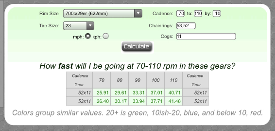

Something is off if you are riding in your biggest gear on 240W. Here’s a gearing/cadence speed matrix: https://www.bikecalc.com/speed_at_cadence
https://i.imgur.com/AmIZ6lM.png?1
I have 50T large rings on all of my bikes (50/34 on my tri bike, 50/36 on my main road bike). On descents in the 50x11, I usually end up spinning out in the low 40s, and then tuck. At my normal cadence (84rpm), that would be good for about 30mph. On flat ground I’m usually in the 50x15 or 17 at 84 rpm, good for low 20s.
A quick comparison over at http://www.gear-calculator.com/ shows that depending on cadence, the difference between a 53x11 and 52x11 is only 0.4mph (60rpm) to 0.8mph (120rpm). So if you’re rarely 90rpm or higher, you’re only giving up 0.4-0.6mph for the same cadence…

There really isn’t much difference between the 52 and 53. I only chose 110 rpm because that’s where I think many people will feel spun out.
52X11 at 110 rpm is 40.9 mph
53X11 at 110 rpm is 41.6 mph
I’d look to see if the bike with the 52 has a 12 tooth cog as the smallest. That would drop you down to 37.5 mph at 110 rpm

Both this and the OP’s post makes little sense unless I misunderstand what’s being claimed. We’re talking about a difference in gearing of just over 1.9% when you change from 53 teeth to 52 teeth, yet you’re both talking as though something dramatic happened to your cadence. It’s very simple maths, if you’re doing 120rpm+ for given conditions on a descent now, you would have been doing 117.7rpm+ with the larger chainring. Is an increase of 2.3rpm really a dramatic issue? There’s nothing mysterious or unpredictable happening here. The gear ratio is the gear ratio. I think we’re all assuming your cassettes haven’t changed since only chainrings have been mentioned? If they have, and as others have said, a change in tooth count for the smallest sprocket will have a much greater impact on the maximum gear ratio.
Yes, you’re all correct re: it really being only small difference - it’s likely just my perceived difference.
