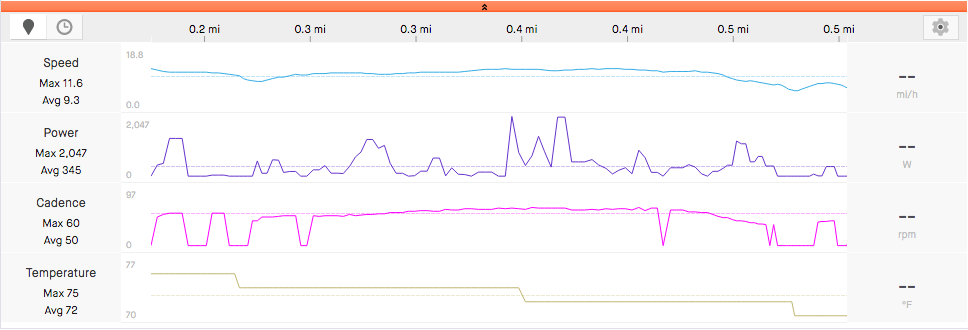

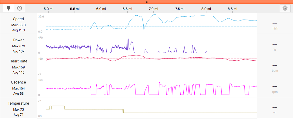

I had one a few years ago that worked OK (as well as you could expect a 1 sided meter to work) until midway through a ride it quit transmitting power, but still registered cadence. I replaced the battery before the next ride, and at first didn’t get anything at all, and then it started giving me really high and inconsistent numbers: soft pedal and it would register 2000-4000w, then sprint and power drops to less than 3 digits. I tried another battery and got the same results. Since I was dealing with a known and fairly significant L/R imbalance, I just gave up and replaced it with Faveros…

This was from just a quick spin around the block after replacing the battery (and wearing flip-flops!):
And this is the moment it went bad a few days earlier. Just crested a climb, and when I started pedaling again I had cadence but no power:
I did a few rides where it only transmitted cadence without power, and then I changed the battery. From that point on, I had power but it was all over the place, often up in 4 digits, and with no correlation to my actual effort.
