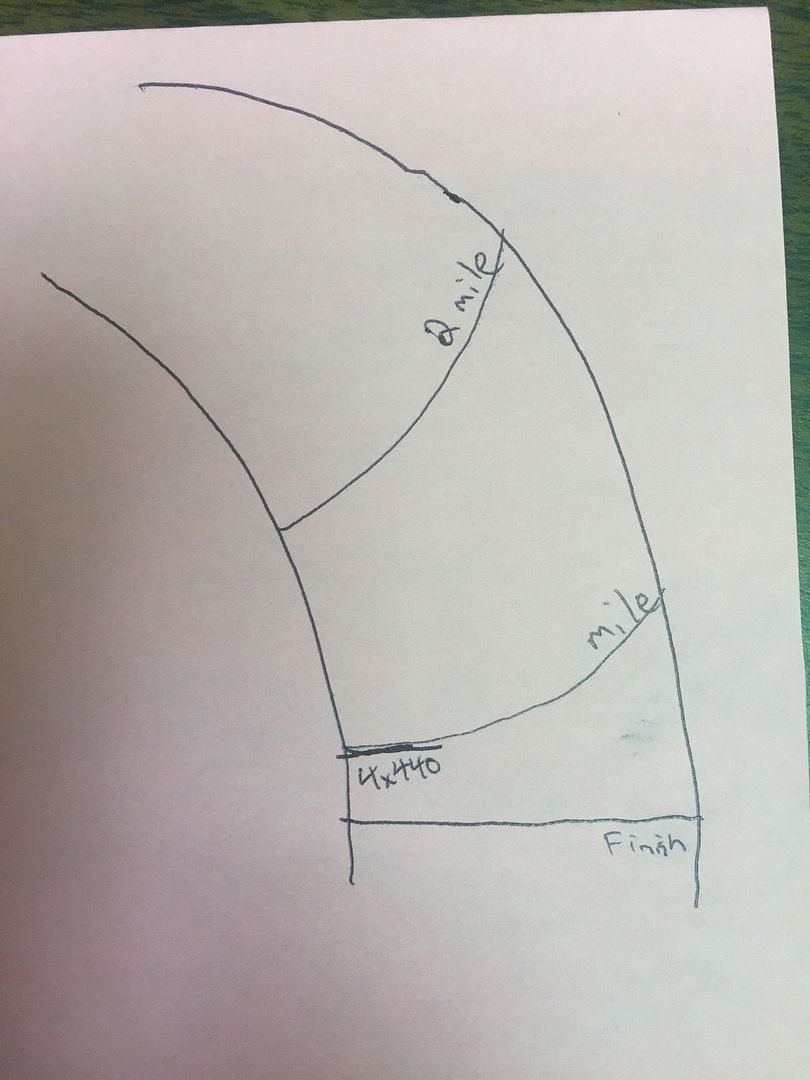

Anyway, what confused me was that it was marked for all the imperial distance races, like 220, 4x110, 880, mile and 2 mile. What I don’t understand is why for example the lane 1 start for the 4x440 as well as the start line for the mile, was just a couple feet in front of the common finish. A 400, 800, 4x400 in lane 1, as well as the start of a 1600 (not a “mile,” which usually still has its own waterfall line 9m behind the finish) on a metric track has you start at the common finish, so I don’t understand why this track was marked that way. It was the first time I have ever run on a 440 yd track, so it confused the hell out of me that a mile was just less than 4 laps.

This is what it looked like. There were other staggered start lines for 440, 4x440,4x110, 880, but I forget where they were relatively. All I remember is the 4x440 for lane 1, as well as the placement of the waterfall lines for the 1 and 2 mile

Even if the track is 442 yards or something stupid like that, the distance from mile start to finish markings should be exactly one half the distance from 2 mile start to finish markings, which according to your drawing, it is not.
Something is definitely off.

edit: I just saw your drawing. That is strange.

Oh my drawing is not to scale whatsoever. The distance from finish to mile start probably was about half the distance from finish to 2-mile. I just have poor fine motor skills and drew this on a Post it note at work.
