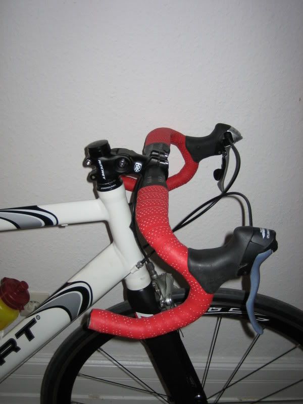

I went budget Zafiro on my TT/road build, inspired by Campled´s excellent bike. Obviously with me being such a cheap arse there was no way I was going to spend any significant money.
I got a set of BBB Wing bars on eBay for €8 sent, with the flat top, and just threw on a set of €20 clipons, not on this picture.
http://i271.photobucket.com/albums/jj158/simon_milan/IMG_3377.jpg
