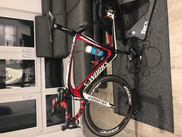

Can you please post a picture of your current set up and we should be able to help.

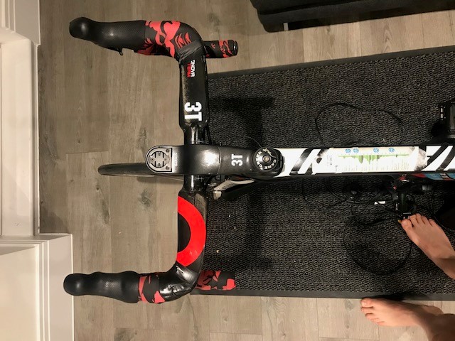

Any suggestions for the clip onbars with the space shown below?

Hmm, it will have to be a clip on with a narrow clamp.
For example I have these (old model) 3T clip ons, which are like the Subsonic:
https://static.evanscycles.com/production/components/handlebars/product-image/Original/3t-clip-on-pro-mount-kit-na-00101904-9999-1.jpg
and the clamp is 35mm wide.
Not sure you have that much width there, looks like only about 20mm beside the stem. You will probably have to choose a clip on that sits above the base bar a bit, like the newer 3T ones (below), unfortunately it will add to your pad stack. (If you change stem to something aggressive you can bring it lower)
https://www.pushys.com.au/media/catalog/product/cache/3/image/9df78eab33525d08d6e5fb8d27136e95/pushys/3/3t-clip-on-31.8mm-aerobar-cradle-and-pad-kit-without-extensions-2410CJAW01.jpg
