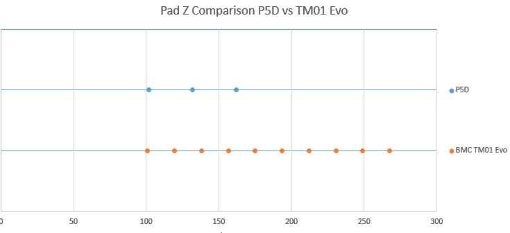

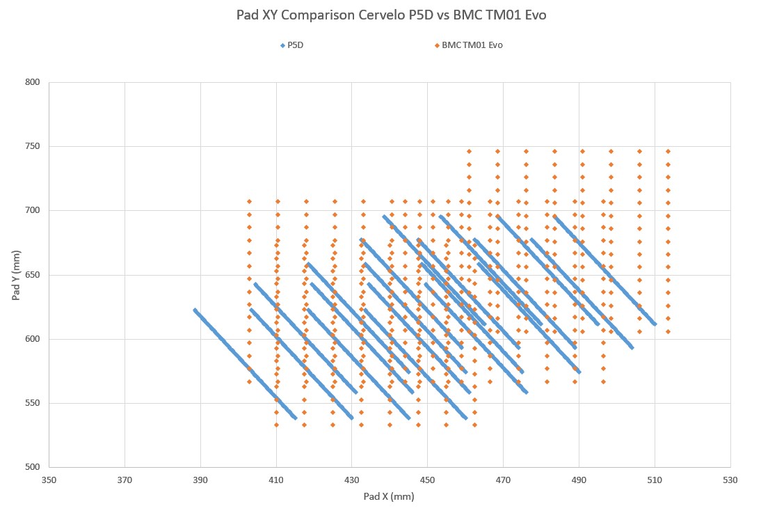

BMC has the advantage of more handlebar adjustability. The P5D has great vertical granularity with the mast, but is weak on x adjustment and terrible on Z (width), it doesn’t tilt either (you can pay more to get the P3X cockpit to improve adjustability).
The BMC (needs to be 2020 with Evo brackets) has fine adjustment and big range for X and Z, with normal 5mm steps in Y. 10deg of tilt on the Evo bracket. Dual seatpost positions plus the sliding clamp give plenty of scope there too.
Graphically
and
Unless you are someone who suits flat forearms and very narrow elbows the P5D is crippled by the bars.
Graphically
and

As mentioned - paying a few hundred $ more allows you to get the P3X cockpit on the P5D, which is much more adjustable (but is increasing the price gap between the bikes you’re considering). Some will attest that you can purchase wedges to add tilt to the armrests on the P5D cockpit but that doesn’t address the narrowness.
The P5D is really narrow, I only have a handful of riders that can handle sub 160mm elbow width. If your setup is uncomfortable you will spend more time sitting up off the aerobars which wipes out any frame aero advantage really quickly.
I always advocate getting the bike with the best bar adjustability - getting your body in an optimal position is the surest path to speed (on the bike choice side of things, training well still more important in the grand scheme)

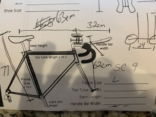

Thank you for asking. The attachment is all I have from the original fitting @ the shop I bought it from. I hope the attachment works. This fit was tweaked as few times later, but I don’t have any notes. This was for a current model Speed Concept - Large. I had one shop tell me to get a medium and another a Large.
Thanks for any help you can offer.
Which saddle was that fit done with?
How many crank arm lengths did the fitter try?
