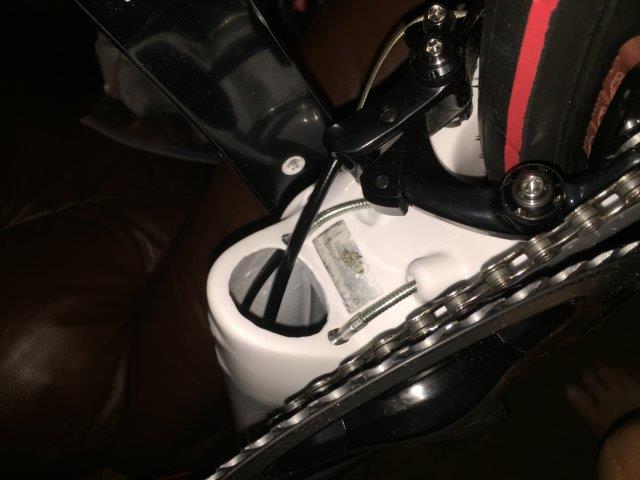

The bike comes bare frame with a parts box complete with stem, cable guides, toolbox, bento box, reversible seatpost, and “instructions”. The instructions are pretty poor, which was a disappointment since the bike is not sold in shops so its the only thing you have to figure out the build. On the plus side, Ceepo was quick to respond with questions. The bike is really designed well for Di2 with a Di2 junction mount under the stem cover and an easy to access battery compartment under the bottom bracket. However, if you are running mechanical there are some odd bends the affect the front shifting a bit (you will need an in-line barrel adjuster to get the correct cable tension). Other than the weird bends the build was pretty simple for a superbike and should be easy to travel with. The stem is a single position stem and comes in either 75mm or 100mm and is pretty easy to install once the headset preload is set correctly. The fork comes uncut which was annoying as the stem only has one position. The only other annoying thing is the fork is cut in such a way that limits the brake choice… no Omega X for me

This is where the bike shines- it rides really well. It is stable, stiff in the right places, and handles very well. It is by far the best handling TT bike I have been on and the weight distribution feels well balanced. I have done a few short climbs on it as well and detected no flew from the BB or chainstay area. I’ve ridden it in some pretty windy conditions with the Enve wheels as well and it held the line well with limited nudging (I am 150 lbs for reference). Braking has been solid which is expected with shimano brakes and shifting has been okay. Rear shifting is great but as noted earlier front shifting is okay due to the odd bend in the cable to the FD.
