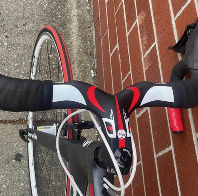

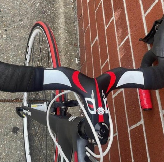

Hi I’m looking to get a 2013 S5 with those wing-shaped handlebars, and I want to see if anyone actually tried to use the ses aero bars and clips? Are the shape of the clip on a good fit for the S5’s handlebars, is it secure enough, does it shift over time etc? Below are the link of the ses clip ons, also attaching a pic of the potentially mine S5 handle bars…
https://revolutionbikeshop.com/…-clip-on-extensions/
