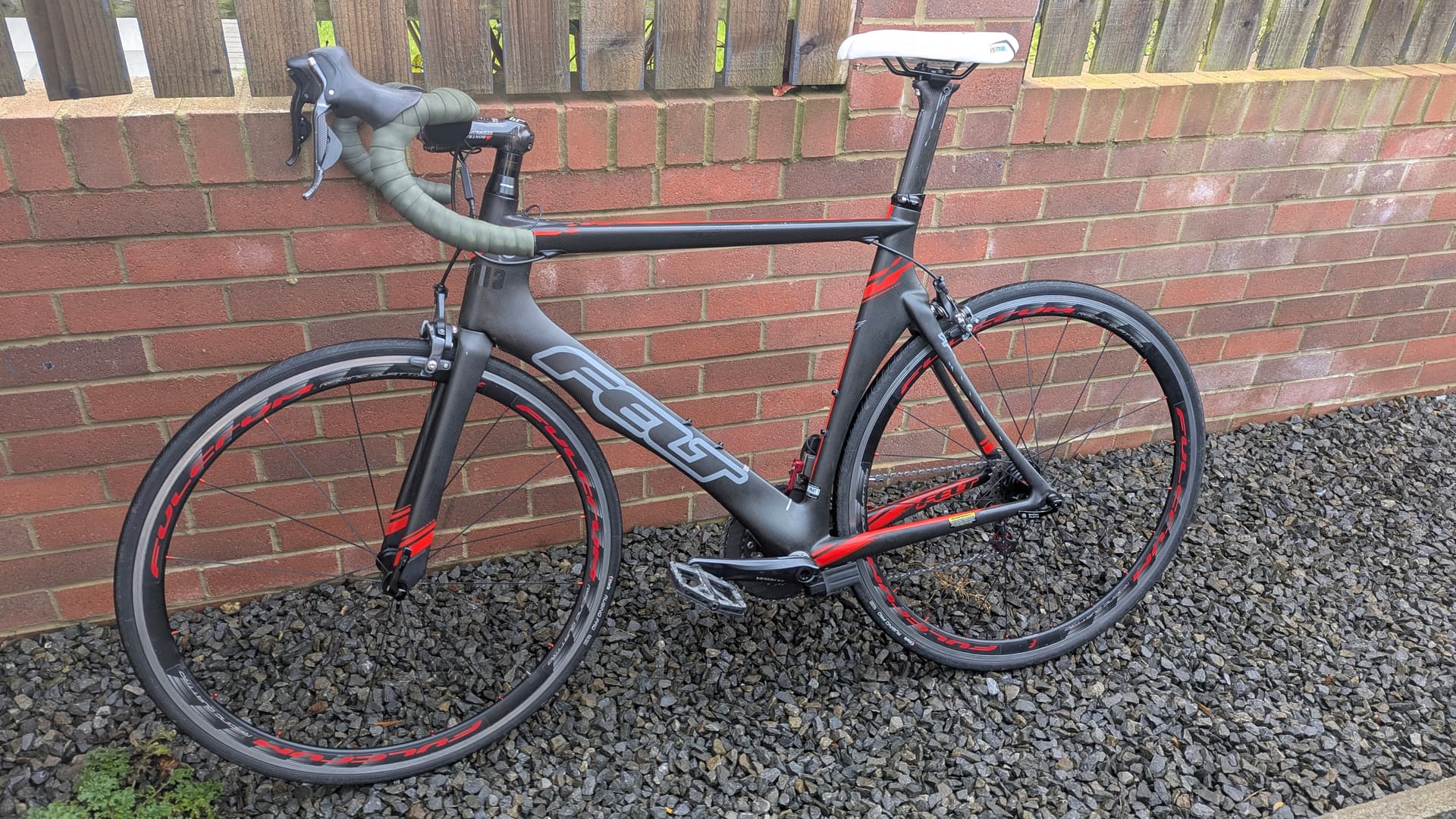

2014 Felt AR2 for Triathalon
Im new to endurance sports and have recently picked up an old (2014 i think ) FELT AR2 fairly cheap to help me do a 70.3. I understand this is an old bike , external battery Di2 , rim brakes etc however for the money i couldnt say no.

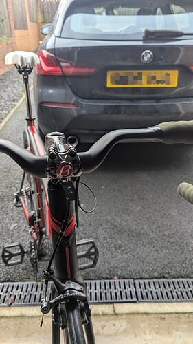

im looking to make it a bit more TT friendly . My proposed changes are :
-Remover Riser bars , install conventional bars with Aero bars
-maybe slightly deeper wheels
-Slam the seat forward .
Some problems I have at the minute
-Frame specific seat post , cant increase offset any further .
-Need to put my clip in pedals on this bike .
-seatpost needs to go down
-bike fit eventually
Has anyone got any other recommendations or have had this bike in the past
I have a 2011 Felt AR2. Great bike for flat rides and climbing/descending. Yes, deeper wheels. Yes clip-in pedals, I use Speedplay. The rest of it is fit-dependent. But this bike is faster than I am.
It’s a great bike.
In this order:
Clip on aerobars
Aero helmet (used, preferably for $ savings). Giro Aerohead is great.
Cheap carbon 50mm wheels for rim-brake. You will need special brake pads, AND your braking will likely get worse than your current setup (since the brake track won’t be alloy anymore) so make sure you practice slowly to get used to it, particularly on downhills and rain. Wheelsets <$600 are just as fast as the $2k+ ones for your purposes. (I’ve tried them both, it’s true.)

Currently got these riser things on and I hate them .I’m wondering weather I bother with normal bars and clip ons or weather I get an integrated tri set up .

You may new handlebars as well.
I bought both on Amazon for less than $40 each before the current trump tariffs. Handlebars are easy to install as well. I had zero problems with using both . The hardest part is getting the aero bars to not slip which took some carbon paste.
I think that for this bike, and the more relaxed seat tube angle versus a steeper tri bike, it wants to be ridden mostly like a road bike, up on the horns. And you’ll want that position if you’re using the bike for street riding and climbing/descending. You can add on a set of clip-on aerobars like those from Profile Design, which is what my bike fit guy @ianpeace put on so I could get into aero for longer races. But in my opinion, adding an integrated tri front end would sacrifice the comfort of having a really good dedicated aero road bike.
