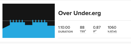

20 minute Over/Under vs Under/Over workouts - preference/opinion?
One of my favorite cycling workouts is 20 minutes of Over/Under (1m @ top of Z4 / 3m @ bottom Z4 x 5).
But there are also Under/Overs too. (3/1 x 5- with the high Z4 coming after the 3rd minute, and the set finishes with 1m @ high Z4). Whenever I’m doing these, I start wondering which is better: over/unders or under/overs…
Curious to hear what people (and coaches) have to say,
GB
