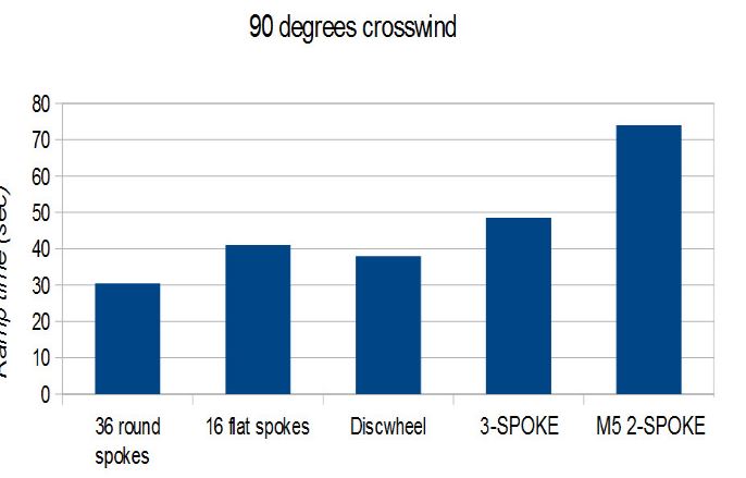

2-Spoke Wheel - huge aero claims: "LOWEST air resistance of ALL existing wheels"
The “M5 Two Spoke” has the LOWEST air resistance of ALL existing wheels compared to 12 or 16 steel bladed spokes or 3, 4, 5, or 6 carbon bladed wheels and even DISC wheels! This means the “M5 Two Spoke” is currently the fastest wheel in the world.
The benefits of this wheel in a one hour time trial compared to a standard carbon 3-spoke wheel can be as much as 2.5 minutes (!) when averaging 51 km/h.
Tested at AeroPro
But no aero data other than this 90 degree crosswind data and some CFD images
Rim width: 23.7 mm rim section. UCI approved.

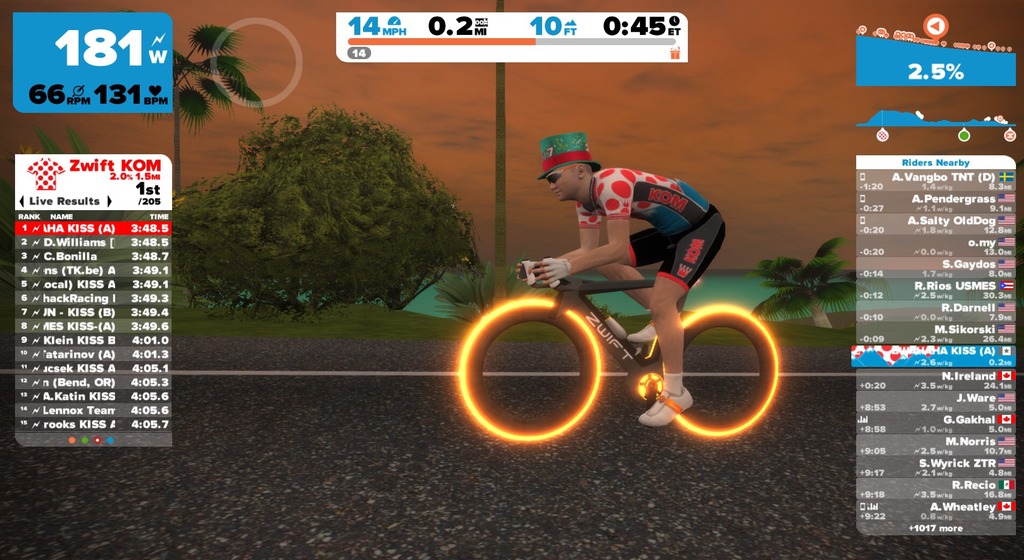

I almost have my Zwift Tron bike. I’m at 97%.
But man is it ugly.
Why aren’t you Zwifting right now then? Or are you?
Ok, first off, what the hell is a 90-degree crosswind? For bike aerodynamics we use yaw angles, which we get from trigonometry – resolving the vectors of bike and wind speed and direction. If you play with the permutations, a wind hitting the side of your bike at 90 degrees isn’t a condition you need to worry about much – unless you like to stand perfectly still during races.

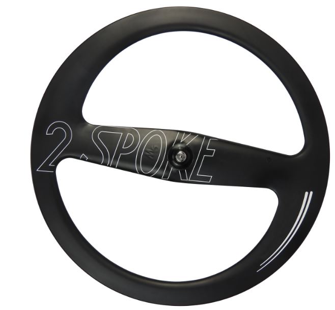

For the items in bold, is it not irrelevant?..if you fill in the spokes with a disk the bike is just resting on the rim. The spoked wheel is just a disk wheel with spacing in the disk. Whether it is a 28 spoked wheel, standard disk wheel, tri spoke, dual spoke, they are all just variants of the Fred Flintstone wheel all with a hub in the middle that the bike attaches. So if you just drew a free body diagram, it’s going to look the same for all the types of wheels at the point where the hub attaches to the fork/chainstay or where the circular wheel touches the ground.

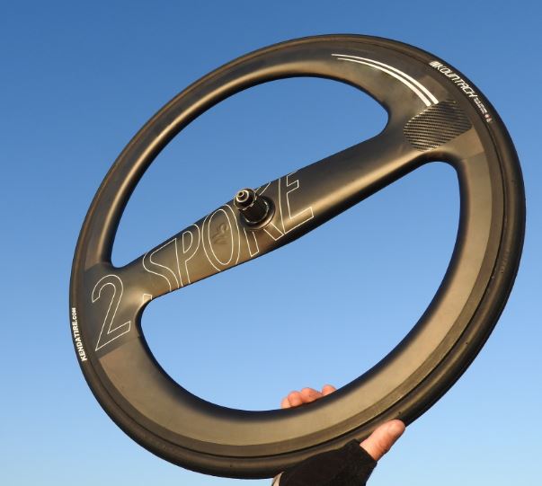

Regardless, I could see a 2 spoke wheel potentially being weak. I’d want to see some pretty substantial destructive testing before trusting one myself.
This wheel has some interesting design ideas but they really need to step it up with their data. It’s likely more stable in cross winds than a tri spoke and it’s also probably harder for a squirrel to get caught in the front wheel :slight_smile:
Imagine the scenario where you hit a pothole or a nasty bump precisely when the two spokes are horizontal. There will be an incredible amount of leverage where the spokes connect to both the rim and the hub. I’m no engineer, but I doubt the wheel is going to be anywhere near as strong in that situation as a wheel that has one or more spokes that are nearly vertical.
The crux of the issue right there. These “data” are fricking retar…, er, useless.
The two spokes should be designed to act structurally as a fixed end beam with a point load at the center. It should have a factor of safety built in to handle impact loads. Hopefully.

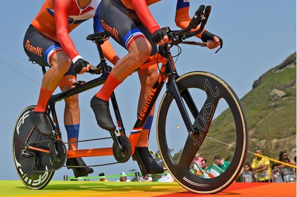

Dutch engineering can’t be trusted either. We built a country below sea level. That is just impossible. The two-spoke is a hoax, they will break into a million pieces over the first pothole. Yes we did send our national tandem to Rio on two-spokes, but everybody knows there’s two riders on a tandem so the stress on the wheel is only half, right? That is just cheating. And the tandem came second, so they lost. Olympic silver is no good.

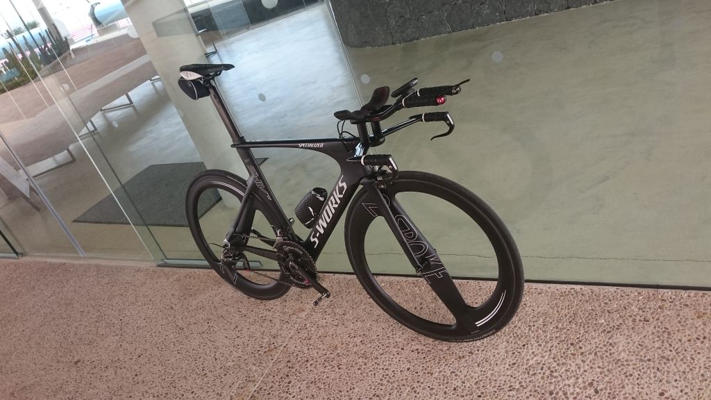

Here is my 2017 bike, looking smug at Club La Santa (I should have removed the saddlebag for the foto). My friends call it the batbike. Mind you, this is a fully UCI-legal TT bike.
PM me if you’re serious and want to test ride the two-spokes, as that can be arranged. I live near Club La Santa (Canarias), a very nice destination for your next training camp. In a field test, your powermeter and GPS will tell you all you need to know. What you will also find out in a test are those little things. How these wheels have a ceramic lining on the rim that gives your brakes a real “bite”. My Shiv-TT used to be downright scary in the descents on all other carbon clinchers, now I can brake into hairpins with confidence. Those are free seconds in every corner. They also make the nicest propeller sound at speed. Something to listen to and keep you in the zone.
