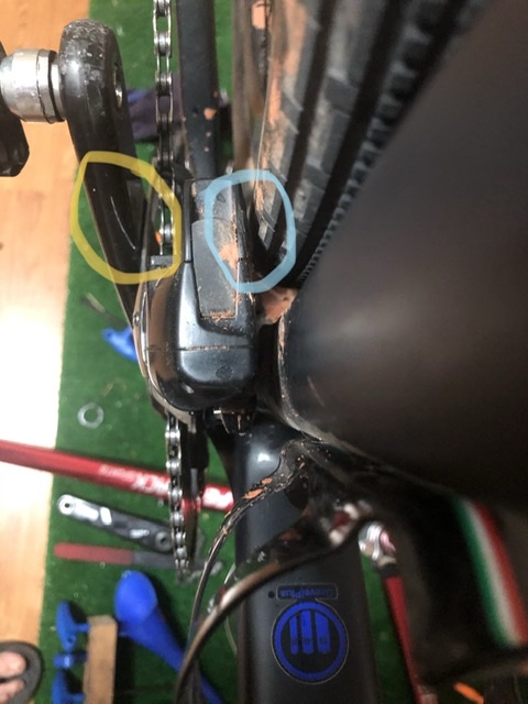

The etap FD is just so flakey for me. Just when I think I have it dialed in I realize the cage is rubbing the crank arm. Or it over shifts. Or it gets jumpy in the big/big. In most races I find myself trying to stay in the big ring all the time anyway because I’m afraid of a bad shift. Not to mention I have a frame that fits 43c, but a 38 is almost rubbing the etap battery.
Edit: in defense of etap, I’m running stock Red chainrings that are two years old and have seen a lot of abuse. I think I’d see significant improvement by buying some praxis rings. The clearance between the crank arm and FD will still be tight, but I think the shifting would dramatically improve over my shark finned rings that are on the bike right now. I can either spend $150 to buy praxis rings, or about $150 to buy a sram xsync 46t and a chain guide, and ditch my FD. I’d rather not buy both options and experiment, although I am tempted. I haven’t heard of anyone trying the chain guide with an etap RD yet.

It’s a good thought. The 3T Exploro has a pretty small max for the inside ring. I forget exactly what size it can go up to, but not 46. 46 is the max 1x size.
I did consider just using a non etap FD with the min and max limit screws set to align the FD on top of the 1x chainring. I have a Red FD is a drawer i could use. It just looks like a dedicated guide has tighter tolerances to prevent drops better.

Here are the right tolerances I’m talking about in the FD area. Pardon the dirty bike.
