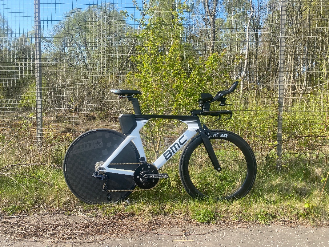

I use the Drag2Zero Chain Guide, Pyramid Narrow Wide with Shimano Ultegra Di2 11 Speed Long rear mech, Ultegra Cassette and Dura Ace Chain.
I’m not sure the Chain Guide is needed only bought it as Front Mech mount is rivited on.
Thinking of removing it doing a few test runs and if as I suspect it’s not then required then biting the bullet and drilling out the rivits on the front mech mount.

What frame are you on?
BMC Timemachine One

BMC Timemachine One
Nice! I don’t think I’ve ever seen a seat on a TT bike set that far back?

BMC Timemachine One
It’s about 5cm behind the Center of Bottom Bracket so pretty much as far back as every UCI setup.
I don’t really need to be UCI Legal but in my third decade of TTing now and know it works for me.
