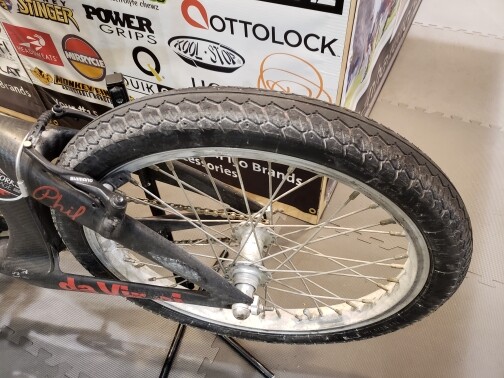

I want to know what kind of tires they used for that. No way a bike tire wouldn’t totally fail at that rotational speed on that small of a diameter.
17" motorcycle tires
