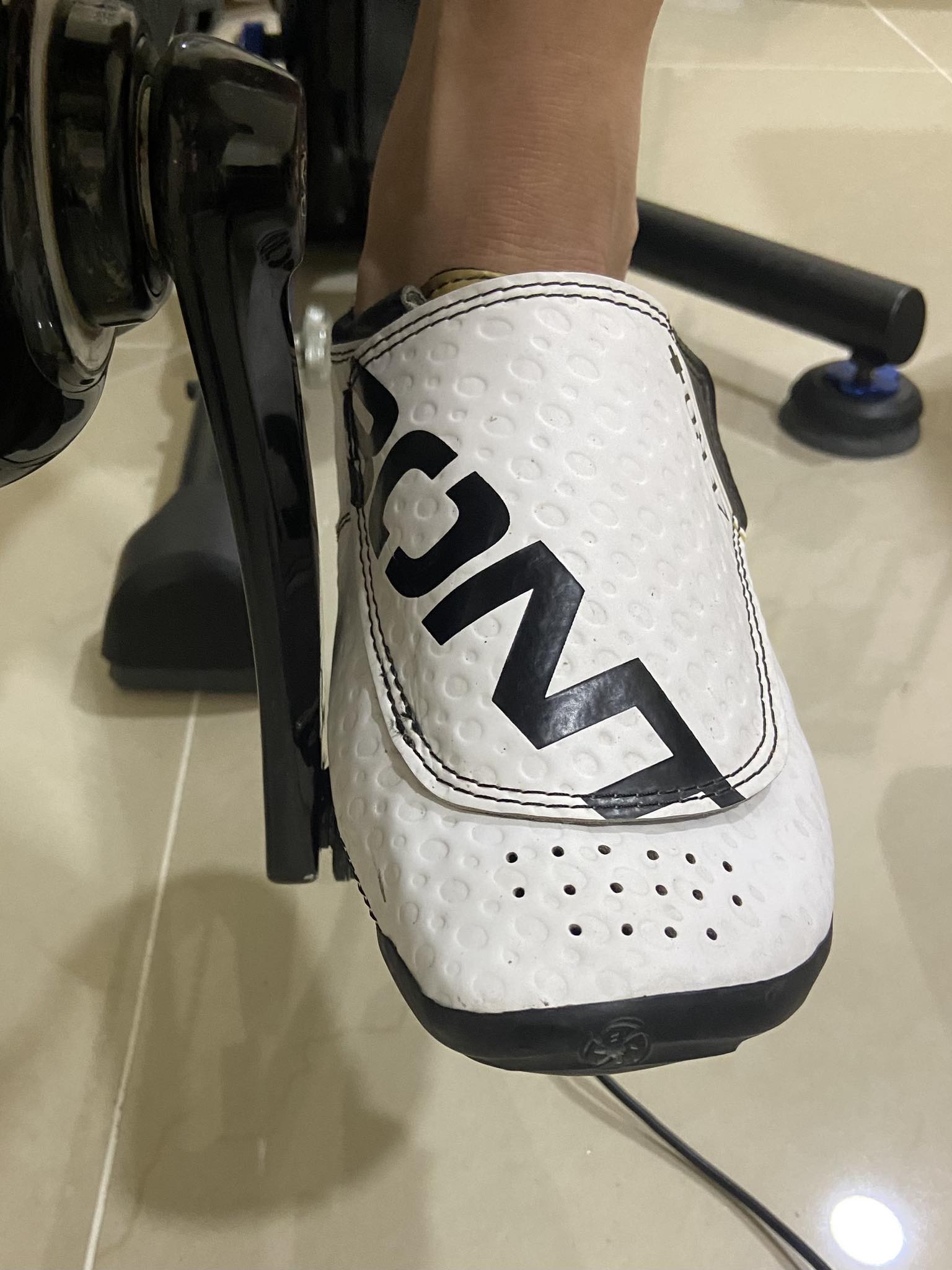

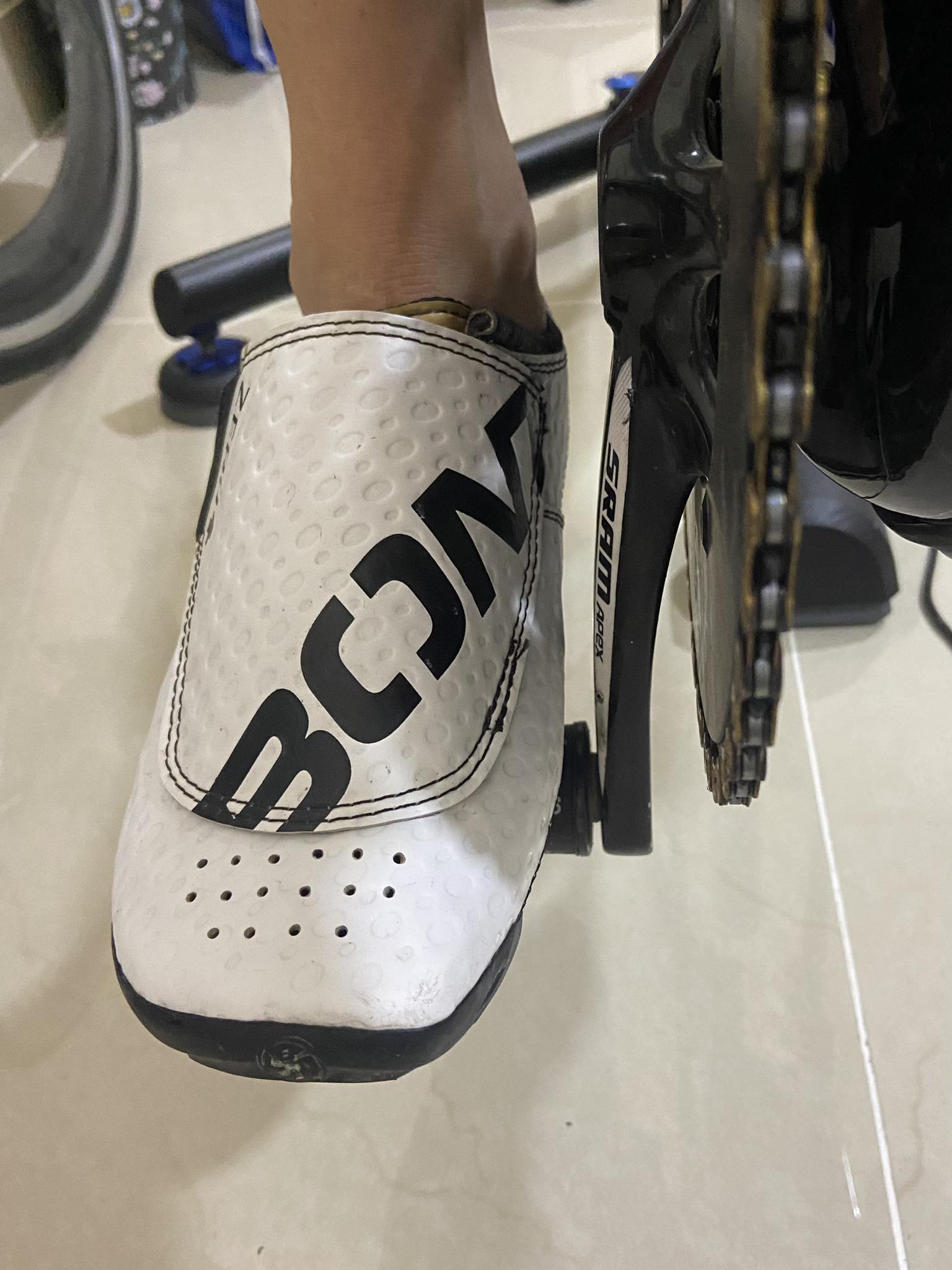

I used an extender plate to make my stance narrow by 10mm - https://www.form-bikefitting.com/...plate-xpu-3-hole-kit
The problem is that the medial side of the shoe hits the crankarms - so I placed a 2mm washer to move the pedals outward and make just a tight spacing that makes it possible for me to pedal without the shoe hitting the crankarms - https://www.form-bikefitting.com/...pedal-spacer-2mm-kit
pic1 - without 10mm extender plate and 2mm spacer
pic 2- with a 10mm extender plate and 2mm spacer = 8mm narrower stance
