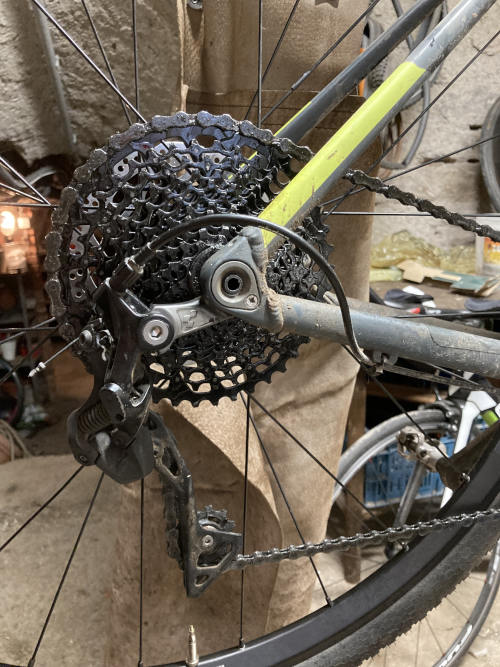

I ordered some stuff (grx 810 rd, roadlink, 11-42 cassette and a 46 chainring) and wanted to build it up today. Roadlink looks like my solution, the manual describes it can handle 11-42 with my rd (dura ace, ultegra, 105 r7000). I bought a sram pg 1130 cassette and I can‘t bring the rd to enter the 42 cog. What cassette did you use? Remember I have a 2x11s drivetrain…

Just to finish that, first thanks to all replies. I switched the big chainring to 46 (now on the crank I have 34/46), changed the chain, mount the 11-42 sram-cassette and leave the 105 rd (7000 series). So far it works good for me, the shifting process is a bit slower but for me absolutely ok.
