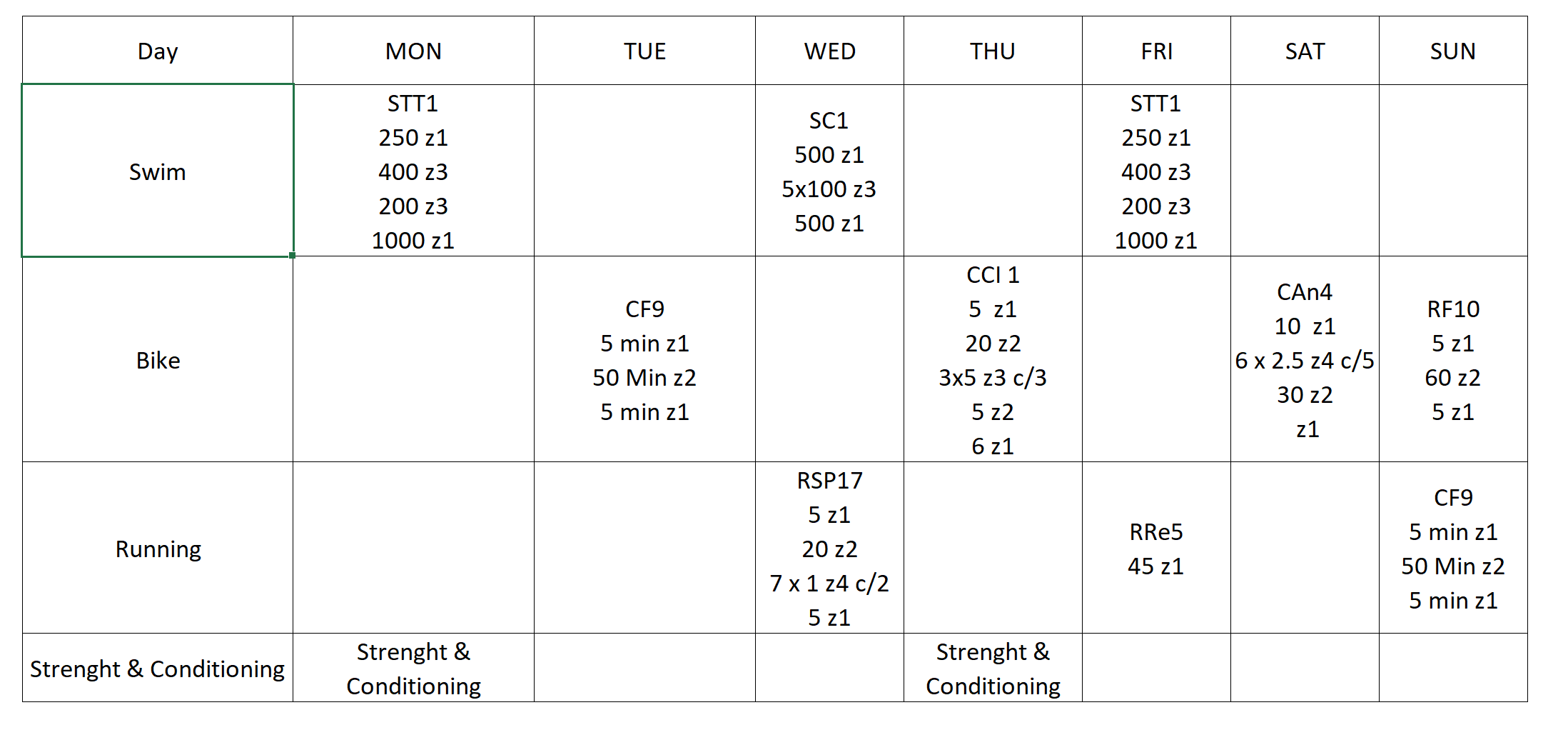

Finally I saw the light, and started my mission as self coached athlete based on the 70.3 - Advanced 80/20 Matt Fitzgerald Book
My first week is like this:
Please let me know any comments I would appreciate it
That B/R training looks extremely light for someone trying for a 70.3 WC slot, especially if you are trying to drop from a 1:50 13.1 run. I would look elsewhere for a training plan.
Thanks
Well I think is the first week of the pre season, I think it will get harder and harder every week (I Guess)
I am very familiar with the 80/20 plans. I think it is a good starting point with where you are at now. I would bump up those swim sets though. Getting in the pool for 2k with a main set of 5x100 is just not worth the time. I would add more reps so the main set is 2,000 yards of reps.
On the bike and run I would settle into the plan for 4-8 weeks and at that time see if you are able to fit in more time in the saddle or running.
