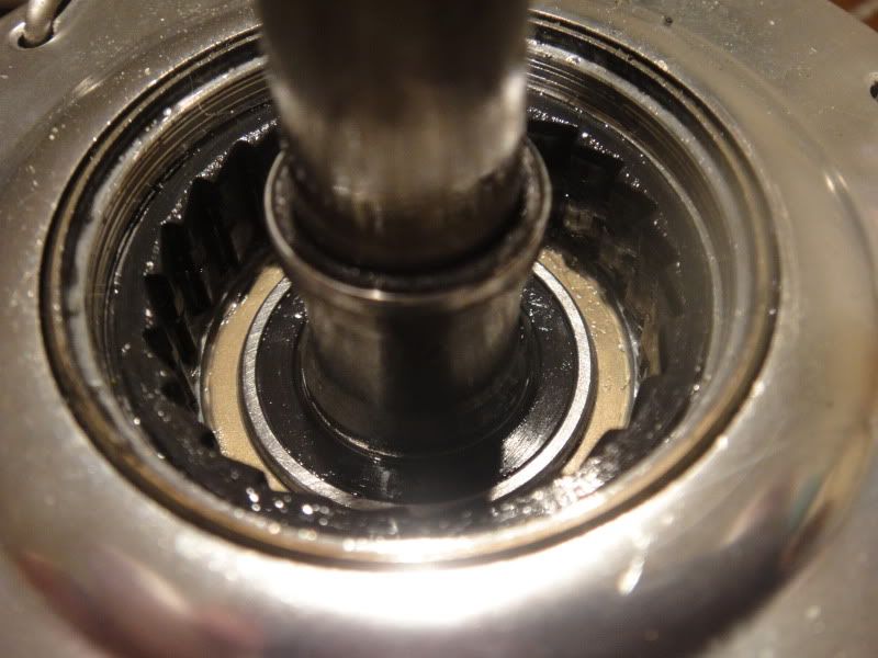

Sometimes when I coast my freehub stops freewheeling and other times when I am off my bike and wheeling it around the crank turns. I have just cleaned the drivetrain really well and it is still doing it. I removed the freehub body from my power tap 2.4 SL and am wondering if there is supposed to be a washer that sits on top of the bearing?
Not sure if that is the source of the problem. If not, any other ideas?

There is a spacer/washer that can go on first before the cassette.
Some hubs it’s not needed and some it is.
I have one PT hub that needs two washers for it to spin freely.
I had the same problem with my PT Elite+ after it came back from a service. I found that the freehub was somewhat loose and when I torqued it to the correct spec, to would bind on the hub body. Backing off about 1/2 a turn made the problem go away.
I fixed it by making a 0.2mm shim that I placed between the shaft shoulder you see in your picture and the inner freehub bearing.
