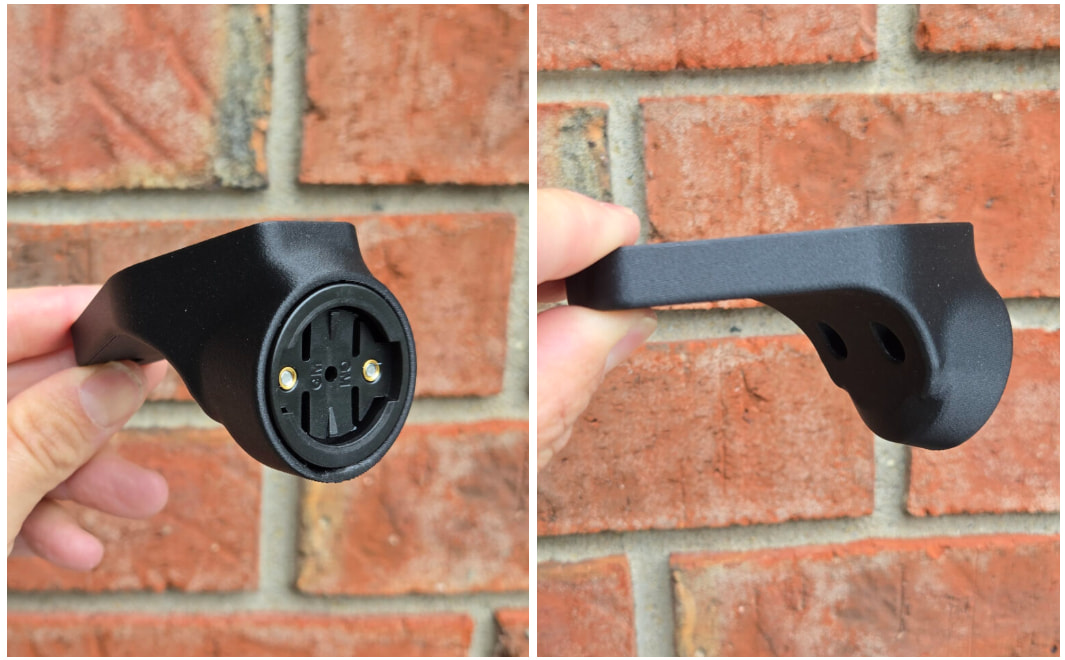

Designed and made myself a new accessory for my Wove saddles - a Garmin Varia Radar/Light combo with the “transition hook” that doubles as a bracket so secure my single and double BTS systems.
I wanted one for my backup/training bike. So I made a new variation. I rely on a 3rd party (injection molded) Garmin interface for safety (instead of a 3D printed bit):
It only works with the non-camera version of the radar light and the angle is fixed at 17.5 deg from the “channel” in the saddle tail so that the radar is close to vertical for my ~4.5 deg saddle tilt. Here it is mounted in combination with the single BTS mount:
With the single BTS mount you need a small index finger to activate the power button of the light, or simply rotate the radar in the quarter-turn mount a bit to power on/off, then put it back in position.
With the side-by-side BTS, the relief in the Carbon Fiber plate provides direct access to the power button.
Here it is mounted on my “mule” / training bike (I just cleaned it and gave it some love - I had forgotten how well it cleans up and ride!):
…and in action on yesterday’s long intervals training ride:
The round relief under the bracket can still act as a “transition hook” to rack the bike in a triathlon transition but I would not use both the radar AND racking the bike like this: unless you lift the bike much higher when pulling the bike off the rack, chances are you knock off the light and maybe damage its mounting interface in the process.
So that little bracket has now 3 uses: secure the BTS, act as a transition hook in a triathlon, and hold a Garmin radar light in training - pretty happy with this one so far. :slight_smile:
I made this for myself, but if someone has one of my kits and would have a use for that, just reach out and we’ll figure something out.
Note: it’s not meant to be used as a ‘standalone’ – the threaded inserts are tilted to match the axis of the screws from my BTS systems (7 deg off vertical) although it would be easy to make a variation of it (or just mount with slightly crooked screws and a nylon or silicone washers, as there is not much weight to deal with here.
