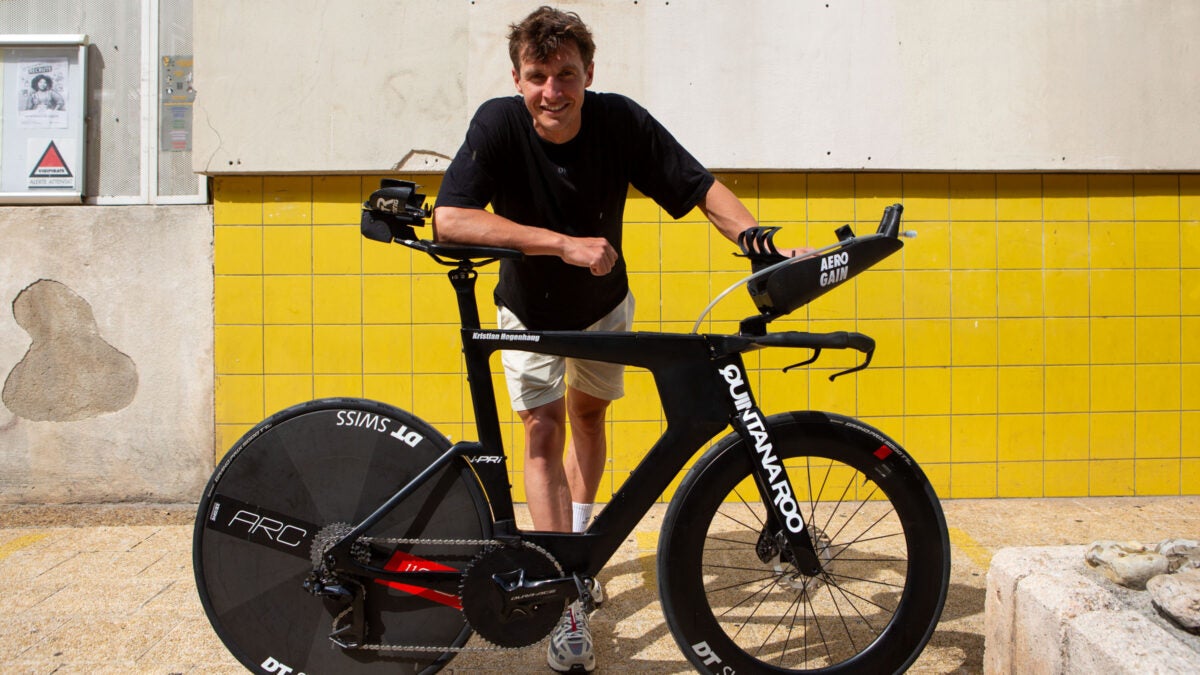

I saw that Matt Hanson’s V-PRI is setup w/out the Q-Box for Nice - wonder if it is rules (which shouldn’t be an issue with the clarifications?) or for weight. And where is he storing spares?
The draft boxes are legal:
So is Hogenhaug. I think this is all about weight.
They also did a nice one on Rudy and Sam.
Rudy’s front end looks a lot nicer. The way that guy descends, glad to see him in a little more orthodox setup.
Maybe the emphasis on weight is making people clean things up
Interesting tire choices by the pros. Hopefully we will get more of these articles
Amusing that the faring pretending to be his TT bars literally has “Aero Gain” written on it :roll_eyes:
