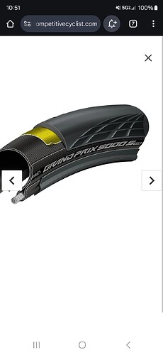

Wheels are 1 season old, Conti GP 5000. The tires don’t come off the rim, they just don’t seal properly when set up tubeless (on these clincher rims, without the bump).
It wasn’t even that the setup was leaking, it’s that it wouldn’t seat at all (at the bead/rim interface, yes). Air compressor turned up as high as goes and it would sometimes push out to the wall but never get any real pressure. So I need something to raise the rim tape high enough that it seals. The secondary hope is that a tighter interface holds the bead a little tighter against the rim as well, without the standard tubeless rim bump/ledge that normally hold it.
Tires are for sure TR or TLR? Or are they clincher version?
Interesting. I’ve never had that happen but there’s a first for everything! Suppose you could give a try and see.
Def the clincher version, the rim profile is the standard U shape smooth bottom
I’ve had this happen to me before - for the cleanest set-up, I usually like to try and seat the tire dry and then inject sealant through the valve stem, install the core and then pump with the floor pump. Some tires (Hutchinson Blackbirds and the Original Cadex Gavias) don’t seat without sealant first…and then its a chore too, because im blasting with a fully charged air compressor while bouncing the wheel at a few spots along the circumference - usually I bounce it int he locations where I see sealant weeping out the side-wall.
Your conti gp5000 is the tubeless ready (TR) version?
There is a standard clincher version too and it would more than likely be hard to seal as it’s not as tight to the rim.
Yep tubeless ready tire, clincher rim
