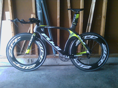

I just built up my D6. I picked up the frame over the winter after that Team Fuji callouts to join the “team.” Did it just to get a discount on the frame. I picked up a 2010 Matty Reed frame from Advanced Sports for $1500. Went 2010 SRAM Force derailulars with Red shifters & brake levers. I went ahead and got the Sram tt chainrings as well, makes it look so much faster.
My advice and this is only because I have had it built and only have about 10 miles on it. The headtube is extremely small. Not typical. Make sure you check reach and stack (As Mr. Frame at the Ball State Performance lab taught me all about it!!) first. I ride a 58cm, so thats what I got. The bike fits me, but really needed to build up the cockpit. I made the mistake of putting a 100mm integrated bar/stem combo on it. After my fit, quickly realized it wasn’t going to work and had to start over. The drop from the seat to the bars is significant. I do have an non-typical shaped body, 6’ even but have a 35.5 inseam.
Check everything out deminsion wise before you make your decision.

Wanksta, doesnt look as if there is any toe overlap on that 58cm. Is that correct? Wish I was tall enough if that is the case.
