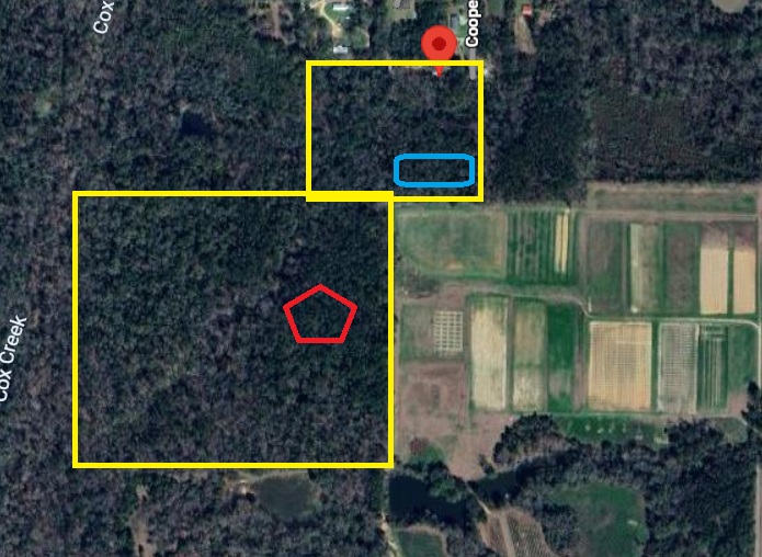

Our property has two parcels. The fields you see on the right are part of the University of Florida agricultural research property and will likely never be developed. We’re probably going to put the house near the red shape. We would have almost unlimited sun if we put the panels where the blue rectangle is, but it would cost a lot to run wiring from that area to the house, and there could be some voltage drop.
We’ll probably clear out an acre or so around the house just to prevent trees from falling on it. We would probably put the panels on the north side of the clearing to maximize exposure to the sun.
