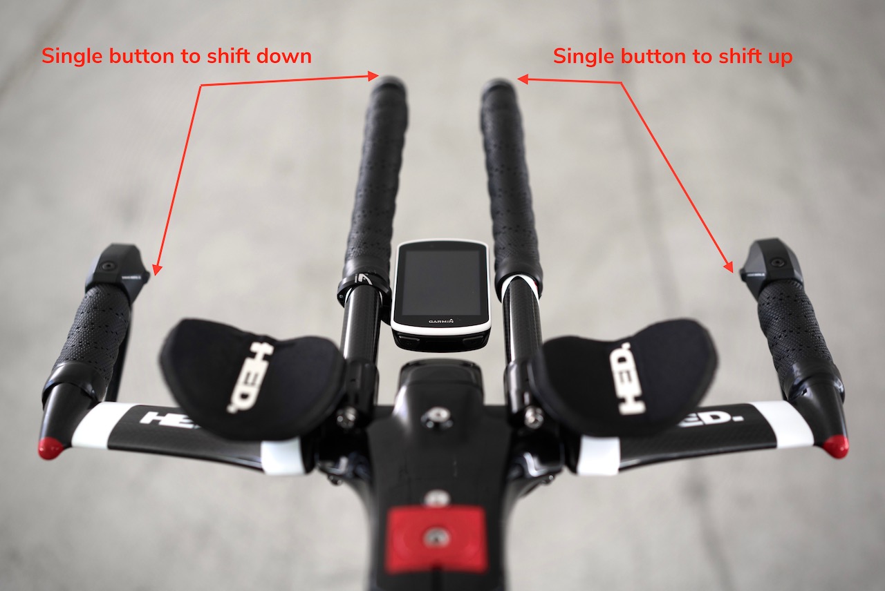

One button on each extension, same for the brake levers. I have mine set up as shifting on the “left” side of the bike to pedal easier, while shifting on the right side of the bike to pedal faster. During a race it is one less thing to think about.
Here is a pic of my extensions with a single button:

Looks clean!! Nice.
