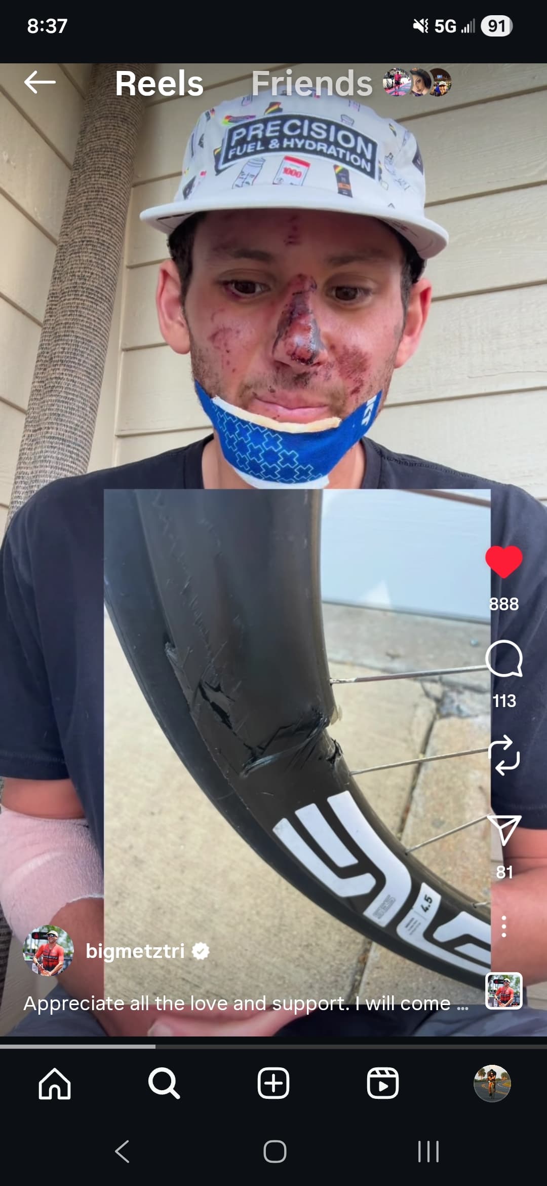

Aren’t these hookless? He says he “hit something and the tire came off the rim”
Yep.. he said he hit a big rock doing like 30 mph hour. We wish that man a speedy recovery.
Actually he said he “Might have hit some debris or a rock in the road.” The last thing he remembers is “his tire falling off the rim”. Here is the link.
In this post yes.. that is 100% what he said.
The first man gets the oyster, the second gets the shell… but also pioneers get killed! Being first is not always the smart move. Let time and the tech sort themselves out. That is why clinchers are still widely used :wink:
I was wondering when his wreck was going to get pulled into the hookless debate.
The picture shows the carbon rim smashed like it hit a big rock. I don’t know if we’ll ever know if that was the cause of or the result of his tire coming off the rim.
