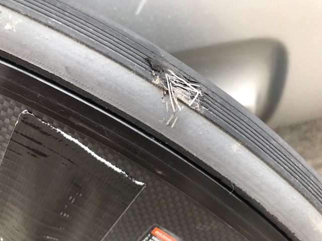

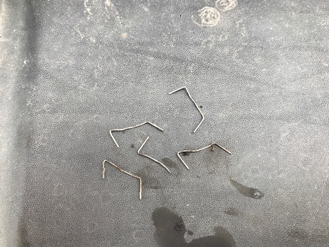

I really like the tubeless setup. After last weekend, I’m a believer after picking up a strip of staples. I actually rode about 15k with these in the tire. I suspected there had been a puncture from the tick tick sound, but I kept riding because sealant wasn’t t flying all over and there was no feeling of pressure loss. Afterwards, I pulled all of them out and the punctures were fully sealed. I checked the pressure and went from 100psi pre ride down to 75psi.
I put in about 3 to 4 oz of orange seal when they were mounted about a month and a half ago.

That is impressive that you could get that many punctures and only lose 25psi
