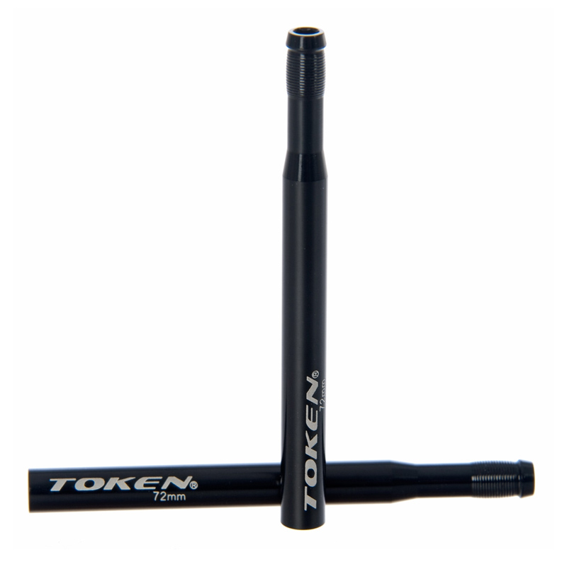

I use valve extenders on my 80mm deep carbon rims. The first extenders I bought were just that, screw-on tubes, and I realised that if I had a slow puncture and wanted to replace the tube I’d have to stick something like a spoke down the extension tube to fully deflate the tube. I also wouldn’t be able to tighten the valve - some tubes leak a bit from the valve if you don’t tighten it.
http://www.slanecycles.com/images/tokenvalveblack.jpg

What is a PITA is when you manage to drop an extension into the cavity of your deep section rim. That is fun to extract :smiley:
