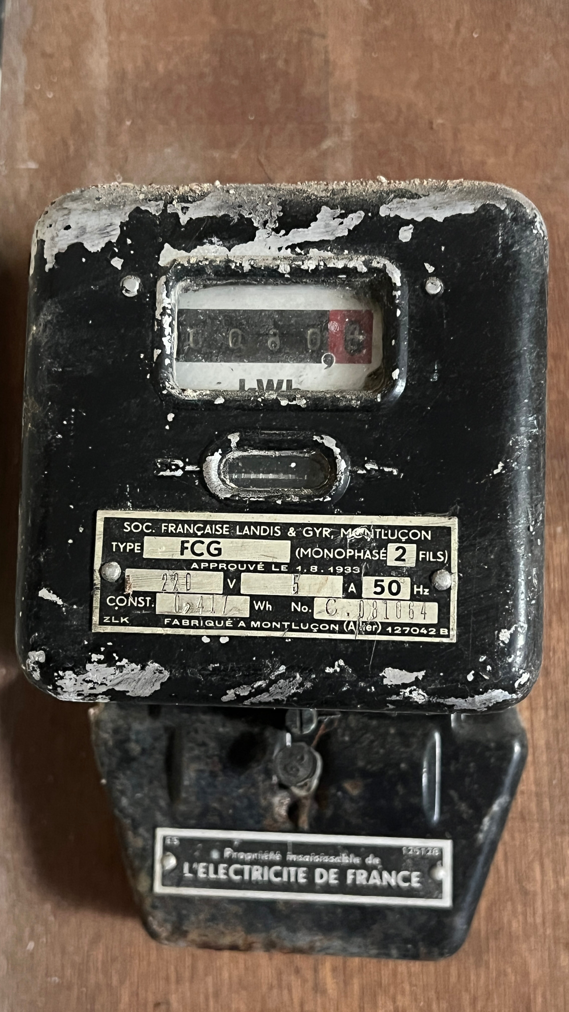

Fun note - the electric meter is dated 1933 and the property was last connected 63 years ago. Before I was born!!!
