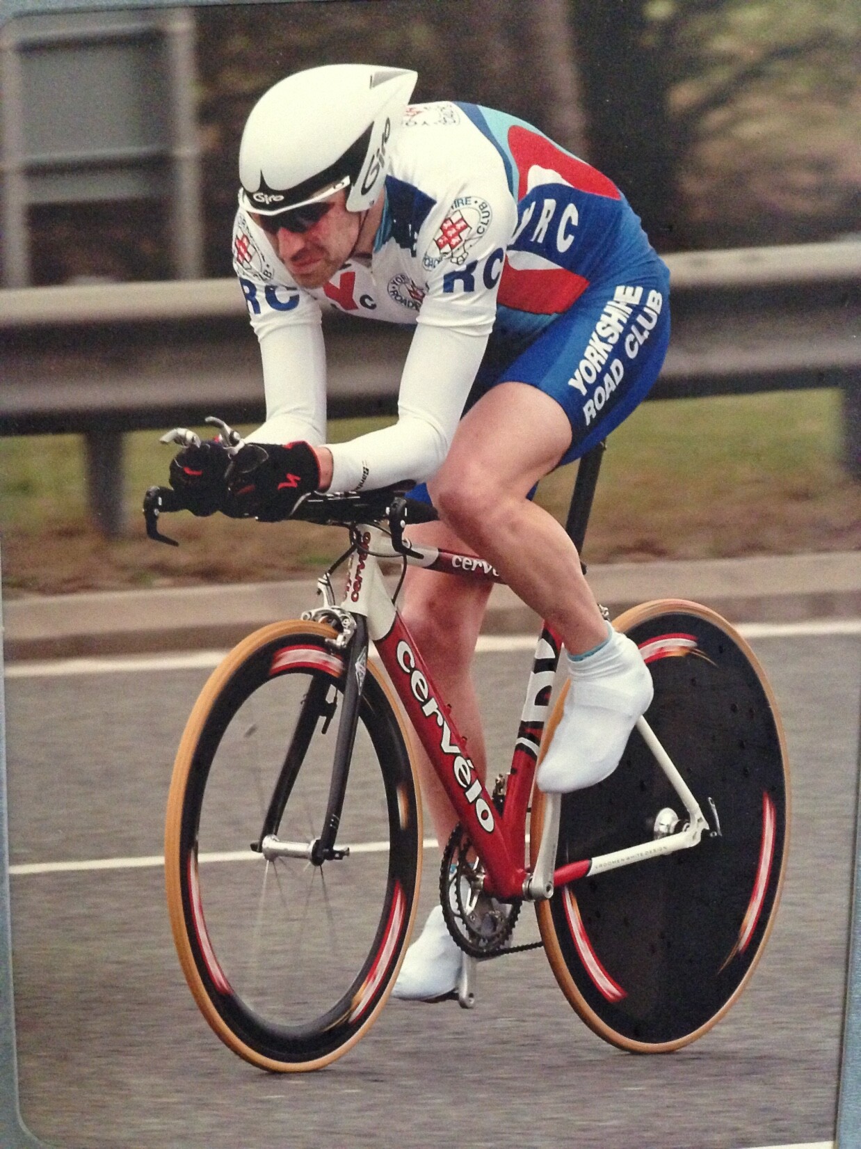

My 50 mile TT pb was set on an original Cervelo Soloist Alu frame with tribars disk wheel etc way back in 2004 with a 1:45 but as I haven’t entered a 50 since I haven’t any feedback on going quicker with a TT frame.
I’m also 20 years older but I’m going much faster over 10 miles than I was in 2004.
